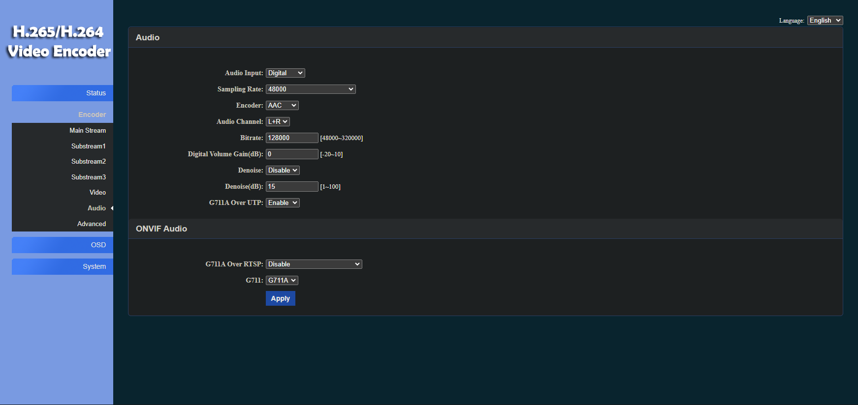

Appreciate the info! To answer your questions - the Uray encoder is brand new, not refurbished or from eBay, and I just purchased to begin the project. The audio has never worked. I have had tried with an Onn box and with a Firestick. When I connect the same Onn box and Firestick to a TV, the audio plays without issue.
I'll compare your settings to mine to see what I come up with. I figured it might be something with the encoder. When it boots up, the audio shows "Normal" and then after a few seconds "No Data". It's almost like it's DRM protected.
Another thing I noticed when looking at your settings... your audio input says "HDMI". I only have the option of "Digital" or "Analog" for some reason. Did you have an HDMI option on your previous device?

I only have HDMI and Analog options. I suspect it is simply a wording difference.
As for the previous device, I had it so briefly I cannot recall ever looking at the audio settings. As soon as I saw this project's potential (within hours of getting it working) I ordered the 4 channel encoder and replaced out the single channel encoder within 48 hours.

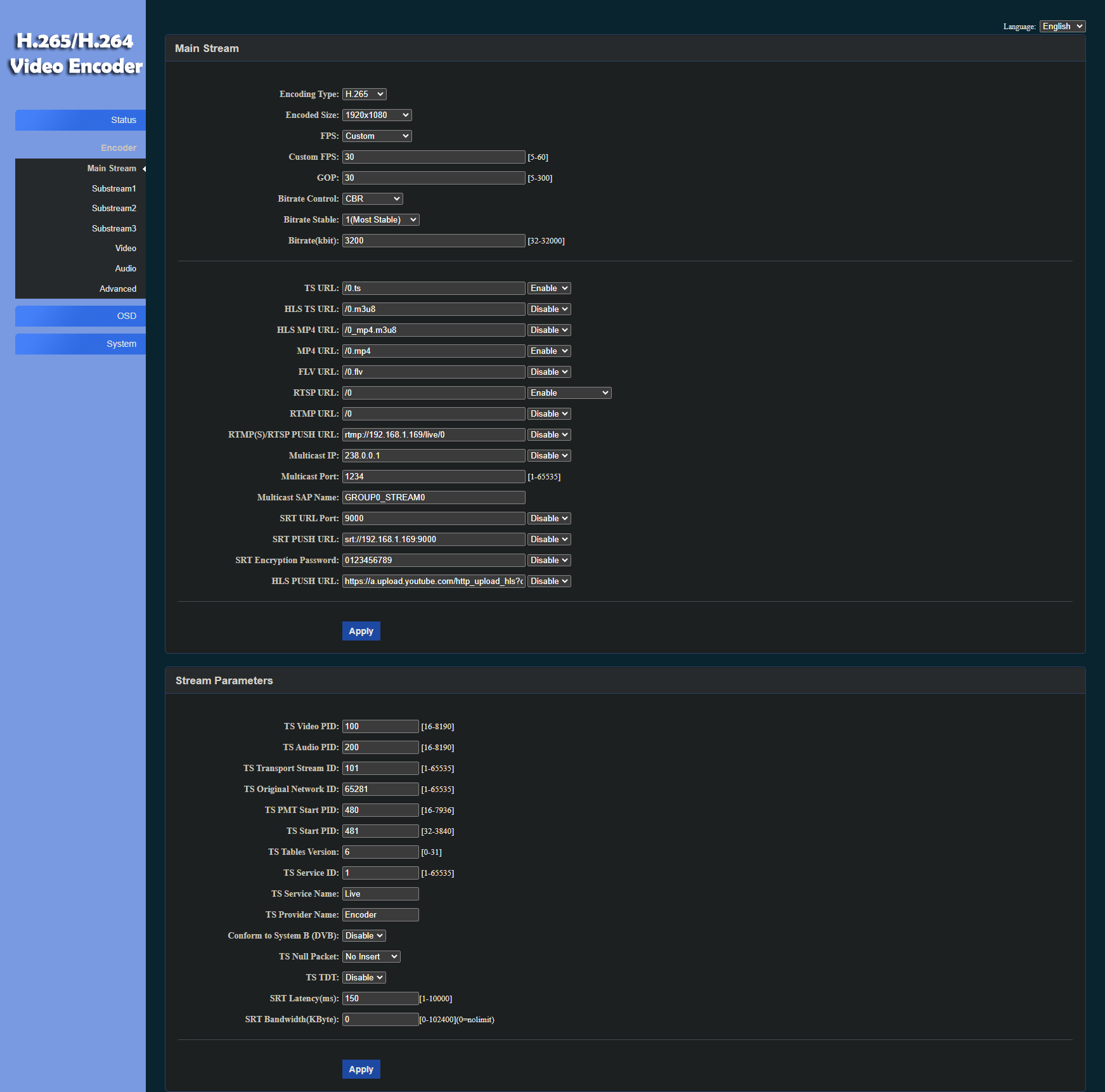

I mentioned this before, but most of my HDMI recordings require a "Fix Video Timestamps" to be performed when complete - I have experimented with a lot of the URay coder settings and can't seem to get anything to consistently make a clean recording (and I have 35+ years of software/hardware engineering experience and 2 degrees in E.E.) - even with the experimental TS-Muxer turned on - the most obvious symptom is that the indicated recording length is not what it should be - is anyone else seeing this?

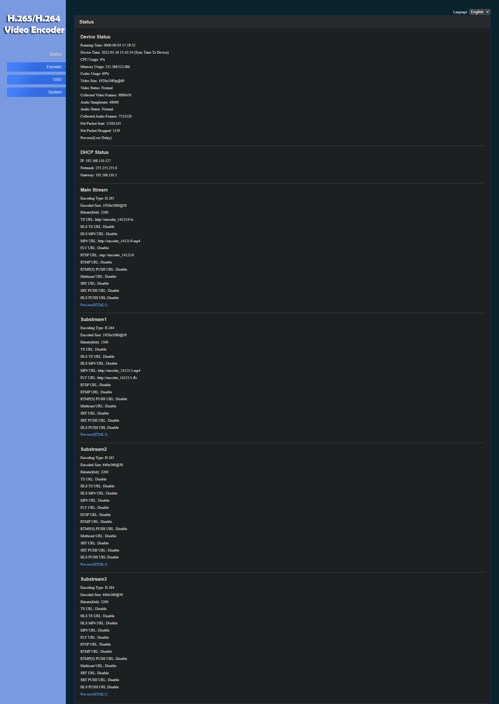

I believe we have the exact same encoder, and I haven't changed a single setting on mine, other than to set it up for DHCP:
We may not have the same encoder firmware though, as I don't have a stream preview on the status page like you, only on the OSD page:

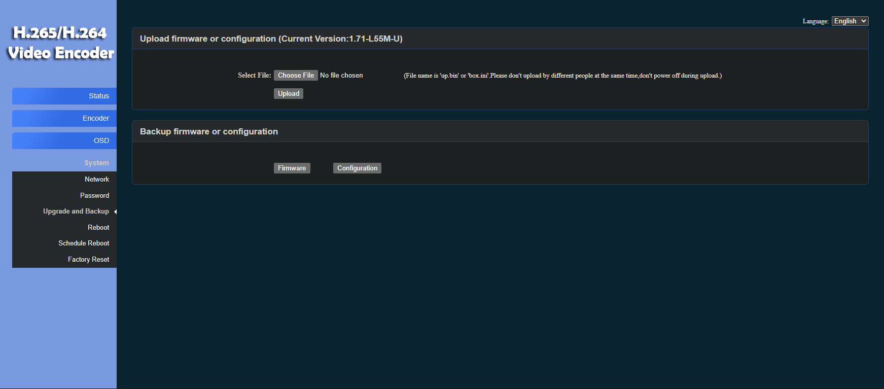

For those with the FBE200 (which might come in different versions), someone suggested earlier in this thread to reach out to their support for the latest firmware, and gave a contact link. I gave it a shot and heard back. They sent me a 2020 firmware file, with this message in the email:
"Sorry, we have discontinued production of FBE200 in 2021. So the latest firmware version is 20201220 and will never be updated again.
Please find attached the latest firmware for FBE200.
I have attached the latest firmware, please check it."
Here is a link to what they sent me. USE THIS AT YOUR OWN RISK. I'm on a Mac, and used an online virus scanning tool, and it came up clean, but I can't vouch for the virus-scanning tool I used. Also, I'm trying to install it now and the progress bar has been stuck at 0% for 10 minutes, so it might not even work with my device. With that disclaimer aside, here is the file:
UPDATE: After a reboot, I was able to install the firmware, and it is showing the latest version on the System page. All looks in order on the admin page, but I haven't tested the actual device yet. For what it's worth, my device still maxes out at 720p, even with this firmware, so there are definitely different versions of the FBE200.
UPDATE 2: Seems to be working fine in my limited use of the device this evening.
UPDATE 3: As mentioned later in this thread, I realized that although the firmware appears to install, it doesn't "stick" and the old firmware is still listed as the current one.
Please try (2) things both in your audio settings for Input Port 1 (one at a time):
  1. Set encoder to AAC
  2. G711A Over RTSO = disabled
What other options do you have for the pulldowns "audio input" and "Audio Channels?"
Additionally, when you look at one of the recorded shows using MediaInfo, what does it say for audio?
pulldowns do not change.
Will not allow disable to be selected. So pulldowns not effected.
Track #1: ATSC A/52A (AC-3)
stereo 256kbps
BTW: I was not the person having the audio problems, that was @David_Darling. My audio is working great. But you replied to me so I gave it a shot to see if any menus changed.
Appreciate the input. I tried changing those but didn’t have any luck. I wasn’t able to make any recordings because I was just trying to get the audio to pass through. I am returning this unit and ordered another… same brand, but different… to see if I have any luck. Appreciate it!
