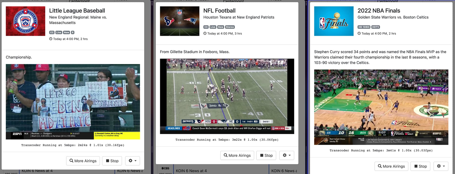

Just experienced a Hulu video lockup again while watching live tv! The HDMI encoder with failure detection/keep_alive.sh is now more reliable than watching directly.
Apple TV latest generation as client.
