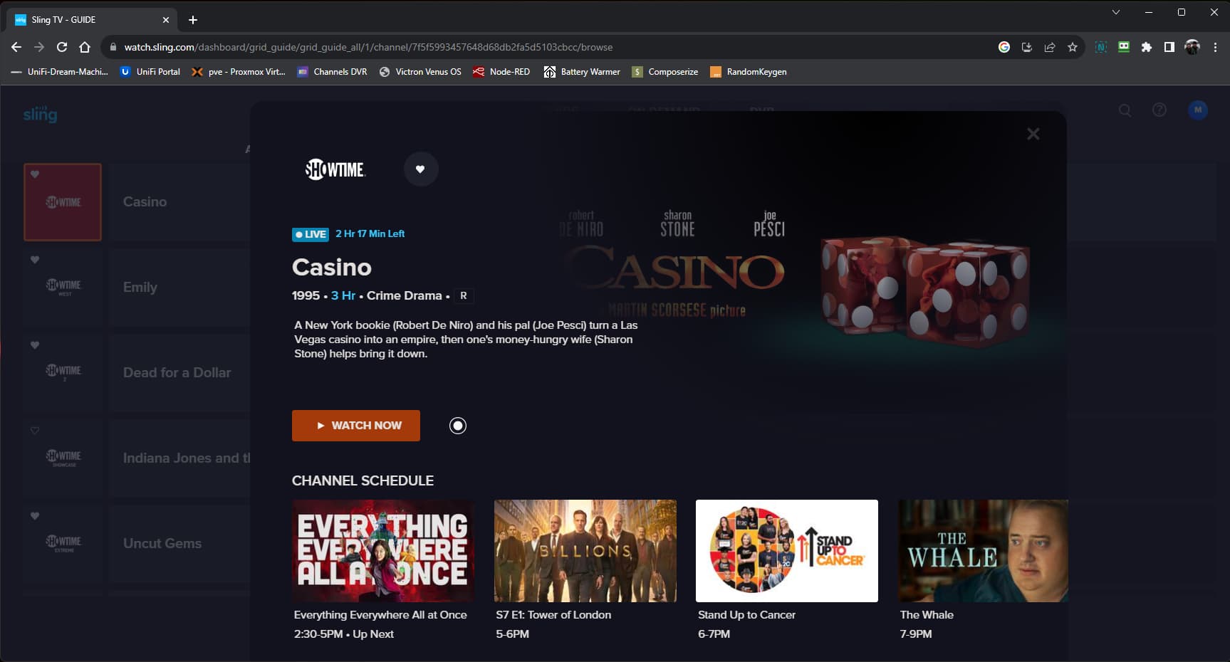

Are you able to log into sling tv and view the channels from your computer? Does each channel have a unique address?
The unique part of the yoututbetv address that I used near the start of this thread as an alternative to automation came from the address that shows up in the browser when you turn each channel from your computer. Does sling hide its address when you use it from a browser?

Hit play for the live stream for show time and see what the address changes to if any at all. Play or Watch now or whatever starts the live stream.
https://watch.sling.com/1/asset/a9f821f3629fd3f4955d56f96eaf45ce/watch

@turtletank @boukmandutty After walking away from the keyboard for a few minutes, I think I have it. It's a bit of a mash-up, but the ID we were after is embedded in the link that shows up when you click on a given channel icon in the (browser) guide:
So the link looks like this for "Showtime Showcase" when not playing anything:
https://watch.sling.com/dashboard/grid_guide/grid_guide_favorites/1/channel/b24b20f009e94eb1ad2441a19f98b7ff/browse
And for that channel the correct deep link would be:
https://watch.sling.com/1/channel/b24b20f009e94eb1ad2441a19f98b7ff/watch
All testing I've done so far has confirmed that this structure works. :slight_smile:
