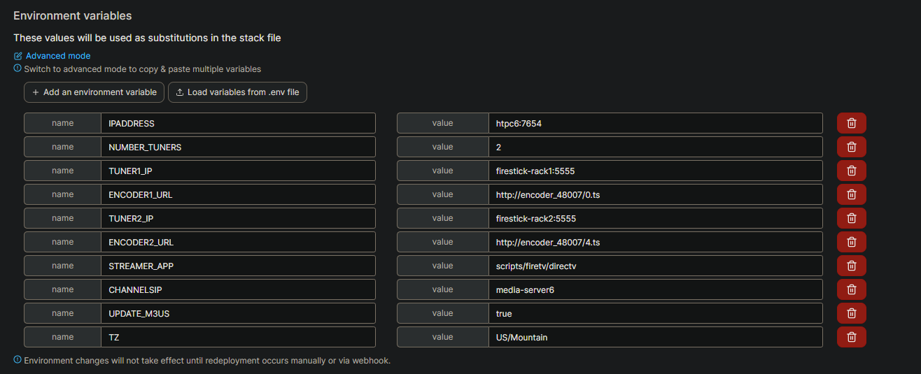

Here's what it would look like in your Portainer environment variables section if you want to update the M3Us only to the latest versions from the repo. The files in question will be overwritten every time you launch or update the container, as long as the env var is set to true:
Also, for those that want to use a couple of encoder ports for one streaming service, and the remaining ports for another -- running two containers is an easy way to accomplish this.
Change the port mapping on the second container (7664 works well), and comment out the adb-server port (this is only needed for specialized scenarios). Also, the second ws-scrcpy needs its own port, so you can change that to 7665 (for example). The data directory bindings can typically stay the same.
As you can see below, the container_name and hostname values have been set to ah4c2.
The IPADDRESS env var would change from htpc6:7654 in my above screenshot to htpc6:7664 for the second container. Your second container's Custom Channels setup (on the Channels DVR Settings page) needs to reflect this alternate port number as well:

Also, it'd be helpful if you could post a screenshot of the environment variables section of your Portainer-Stack.

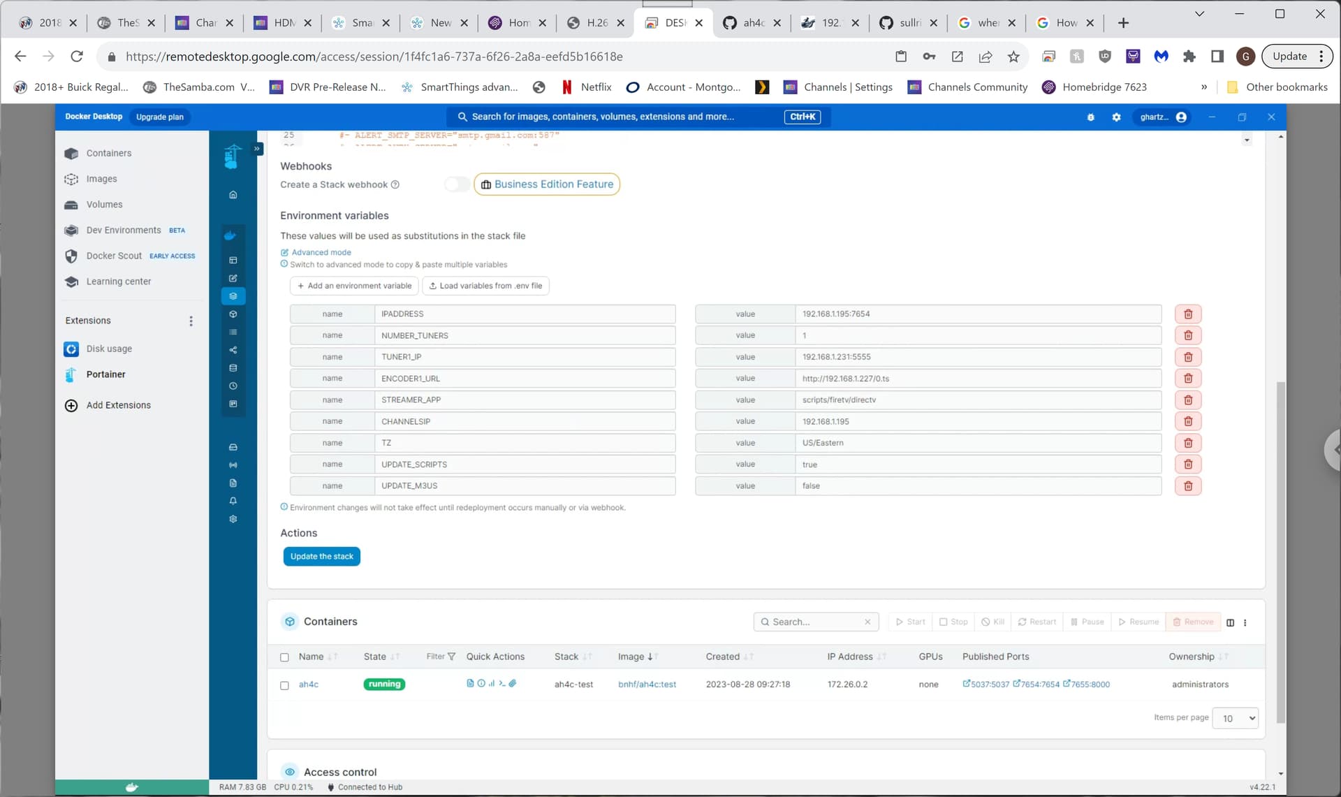

OK, so let's try this: Launch ws-scrcpy in a browser tab, which for you would be http://192.168.1.195:7655. Then click on shell, and enter: logcat | grep "ActivityManager: START.*cmp=" and post the output here. It should look something like this:
