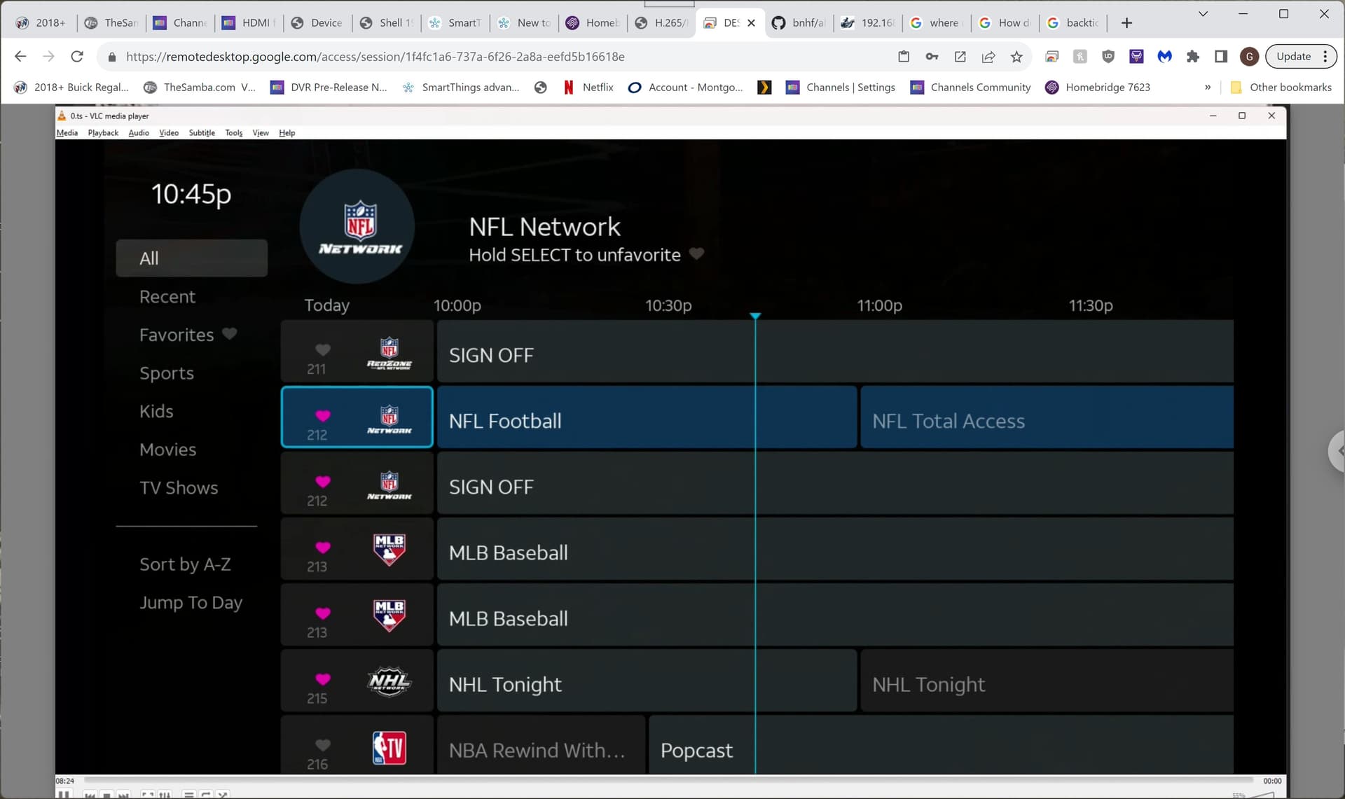

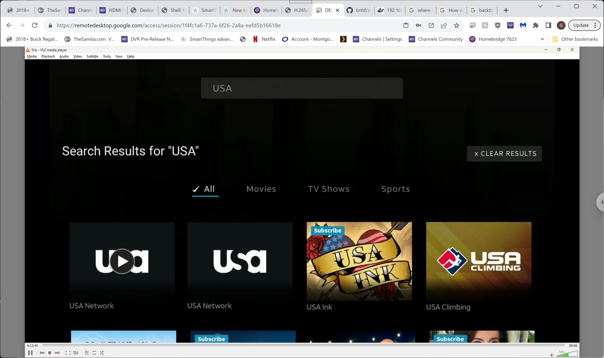

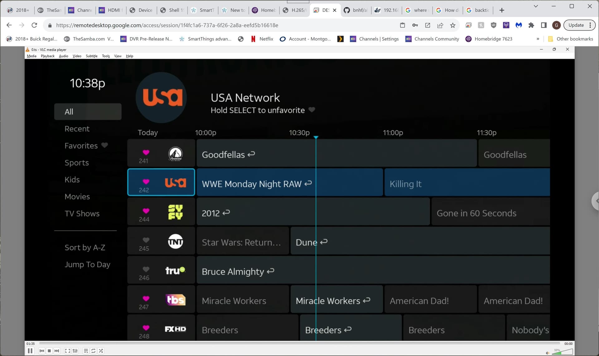

2023-08-28T22:59:03.898830888Z [EXECUTE] Running [./scripts/firetv/directv/prebmitune.sh 192.168.1.231:5555]
2023-08-28T22:59:06.527187133Z [EXECUTE] Stdout: 'already connected to 192.168.1.231:5555
2023-08-28T22:59:06.527204234Z Starting: Intent { cmp=com.att.tv/com.clientapp.MainActivity }
2023-08-28T22:59:06.527207234Z Warning: Activity not started, its current task has been brought to the front
2023-08-28T22:59:06.527209834Z Waking 192.168.1.231:5555
2023-08-28T22:59:06.527211934Z prebmitune.sh is exiting for 192.168.1.231:5555 with exit code 0
2023-08-28T22:59:06.527214134Z '
2023-08-28T22:59:06.527216234Z [EXECUTE] Stderr: '+ streamerIP=192.168.1.231:5555
2023-08-28T22:59:06.527218434Z + streamerNoPort=192.168.1.231
2023-08-28T22:59:06.527220534Z + adbTarget='adb -s 192.168.1.231:5555'
2023-08-28T22:59:06.527222634Z + mkdir -p 192.168.1.231
2023-08-28T22:59:06.527224735Z + trap finish EXIT
2023-08-28T22:59:06.527226835Z + main
2023-08-28T22:59:06.527228935Z + adbConnect
2023-08-28T22:59:06.527231035Z + adb connect 192.168.1.231:5555
2023-08-28T22:59:06.527233235Z + local -i adbMaxRetries=25
2023-08-28T22:59:06.527235335Z + local -i adbCounter=0
2023-08-28T22:59:06.527237435Z + true
2023-08-28T22:59:06.527239535Z + adb -s 192.168.1.231:5555 shell input keyevent KEYCODE_WAKEUP
2023-08-28T22:59:06.527241735Z + local adbEventSuccess=0
2023-08-28T22:59:06.527243835Z + [[ 0 -eq 0 ]]
2023-08-28T22:59:06.527245935Z + break
2023-08-28T22:59:06.527247935Z + adbWake
2023-08-28T22:59:06.527250035Z + packageLaunch=com.clientapp.MainActivity
2023-08-28T22:59:06.527252535Z + packageLaunchAlternate=tv.youi.clientapp.AppActivity
2023-08-28T22:59:06.527254636Z + packageName=com.att.tv
2023-08-28T22:59:06.527256736Z ++ adb -s 192.168.1.231:5555 shell pidof com.att.tv
2023-08-28T22:59:06.527258836Z + packagePID=19404
2023-08-28T22:59:06.527260936Z + '[' '!' -z 19404 ']'
2023-08-28T22:59:06.527263036Z + adb -s 192.168.1.231:5555 shell input keyevent KEYCODE_WAKEUP
2023-08-28T22:59:06.527265236Z ++ adb -s 192.168.1.231:5555 shell am start -n com.att.tv/com.clientapp.MainActivity
2023-08-28T22:59:06.527267436Z + packageError='Starting: Intent { cmp=com.att.tv/com.clientapp.MainActivity }
2023-08-28T22:59:06.527269636Z Warning: Activity not started, its current task has been brought to the front'
2023-08-28T22:59:06.527280836Z + echo 'Starting: Intent { cmp=com.att.tv/com.clientapp.MainActivity }
2023-08-28T22:59:06.527283236Z Warning: Activity not started, its current task has been brought to the front'
2023-08-28T22:59:06.527285337Z + echo 'Starting: Intent { cmp=com.att.tv/com.clientapp.MainActivity }
2023-08-28T22:59:06.527287437Z Warning: Activity not started, its current task has been brought to the front'
2023-08-28T22:59:06.527289637Z + grep -q 'Error type 3'
2023-08-28T22:59:06.527291737Z + echo 'Waking 192.168.1.231:5555'
2023-08-28T22:59:06.527293837Z + touch 192.168.1.231/adbAppRunning
2023-08-28T22:59:06.527296037Z + finish
2023-08-28T22:59:06.527298137Z + echo 'prebmitune.sh is exiting for 192.168.1.231:5555 with exit code 0'
2023-08-28T22:59:06.527300337Z '
2023-08-28T22:59:06.527302437Z [EXECUTE] Finished running ./scripts/firetv/directv/prebmitune.sh in 2.628536352s
2023-08-28T22:59:06.527610847Z [EXECUTE] Running [./scripts/firetv/directv/bmitune.sh 242 192.168.1.231:5555]
2023-08-28T22:59:32.093067541Z [IO] io.Copy: write tcp 192.168.32.2:7654->192.168.32.1:49530: write: broken pipe
2023-08-28T22:59:32.093134542Z [IOINFO] Successfully copied 28077260 bytes
2023-08-28T22:59:32.093144042Z [IOINFO] Transfer speed: 8.78581465699478 Mbits/second
2023-08-28T22:59:32.093150843Z Performing Close() for 192.168.1.231:5555
2023-08-28T22:59:32.093157343Z [EXECUTE] Running [./scripts/firetv/directv/stopbmitune.sh 192.168.1.231:5555]
2023-08-28T22:59:37.547658668Z Tuner 0 is active - skipping
2023-08-28T22:59:37.547933068Z [ERR] Failed to tune device(s) not available
2023-08-28T22:59:37.548235468Z [GIN-debug] Request: 192.168.32.1 GET /play/tuner/281, latency: 552.3ยตs, status: 500
2023-08-28T22:59:47.987664327Z [EXECUTE] Stdout: 'Not a special channel (exit nor reboot)
2023-08-28T22:59:47.987685327Z Current app in focus is mCurrentFocus=null
2023-08-28T22:59:47.987689827Z Current PID for this script is 91
2023-08-28T22:59:47.987693427Z Active audio stream not yet detected -- loudness is -70.0 LUF. Continuing...
2023-08-28T22:59:47.987697128Z Active audio stream not yet detected -- loudness is -70.0 LUF. Continuing...
2023-08-28T22:59:47.987700628Z Active audio stream detected with -13.4 LUF.
2023-08-28T22:59:47.987704128Z bmitune.sh is exiting for 192.168.1.231:5555 with exit code 0
2023-08-28T22:59:47.987711028Z '
2023-08-28T22:59:47.987716628Z [EXECUTE] Stderr: '+ channelID='"242"'
2023-08-28T22:59:47.987721328Z + specialID=242
2023-08-28T22:59:47.987725428Z + streamerIP=192.168.1.231:5555
2023-08-28T22:59:47.987729628Z + streamerNoPort=192.168.1.231
2023-08-28T22:59:47.987733528Z + adbTarget='adb -s 192.168.1.231:5555'
2023-08-28T22:59:47.987737228Z + trap finish EXIT
2023-08-28T22:59:47.987741128Z + main
2023-08-28T22:59:47.987756728Z + matchEncoderURL
2023-08-28T22:59:47.987762728Z + case "$streamerIP" in
2023-08-28T22:59:47.987765728Z + encoderURL=http://192.168.1.227/0.ts
2023-08-28T22:59:47.987767828Z + specialChannels
2023-08-28T22:59:47.987770028Z + packageName=com.att.tv
2023-08-28T22:59:47.987772128Z + '[' 242 = exit ']'
2023-08-28T22:59:47.987774229Z + '[' 242 = reboot ']'
2023-08-28T22:59:47.987776729Z + [[ -f 192.168.1.231/adbCommunicationFail ]]
2023-08-28T22:59:47.987778829Z + echo 'Not a special channel (exit nor reboot)'
2023-08-28T22:59:47.987780929Z ++ adb -s 192.168.1.231:5555 shell dumpsys window windows
2023-08-28T22:59:47.987783029Z ++ grep -E mCurrentFocus
2023-08-28T22:59:47.987785129Z ++ cut -d / -f1
2023-08-28T22:59:47.987787329Z ++ sed 's/.* //g'
2023-08-28T22:59:47.987789429Z + appFocus=mCurrentFocus=null
2023-08-28T22:59:47.987791529Z + echo 'Current app in focus is mCurrentFocus=null'
2023-08-28T22:59:47.987793629Z + launchDelay
2023-08-28T22:59:47.987795729Z + local lastChannel
2023-08-28T22:59:47.987797829Z + local lastAwake
2023-08-28T22:59:47.987799929Z + local timeNow
2023-08-28T22:59:47.987802029Z + local timeElapsed
2023-08-28T22:59:47.987804129Z + local maxTime=14400
2023-08-28T22:59:47.987806229Z + mkdir -p 192.168.1.231
2023-08-28T22:59:47.987808329Z + [[ -f 192.168.1.231/stream_stopped ]]
2023-08-28T22:59:47.987810429Z + echo 0
2023-08-28T22:59:47.987812529Z + [[ -f 192.168.1.231/last_channel ]]
2023-08-28T22:59:47.987814629Z + echo 0
2023-08-28T22:59:47.987816629Z + echo 91
2023-08-28T22:59:47.987818729Z + echo 'Current PID for this script is 91'
2023-08-28T22:59:47.987820829Z + lastChannel=0
2023-08-28T22:59:47.987822929Z + lastAwake=0
2023-08-28T22:59:47.987825029Z ++ date +%s
2023-08-28T22:59:47.987827129Z + timeNow=1693263547
2023-08-28T22:59:47.987829229Z + timeElapsed=1693263547
2023-08-28T22:59:47.987831329Z + ((  0 == 242  ))
2023-08-28T22:59:47.987833429Z + '[' -f 192.168.1.231/adbAppRunning ']'
2023-08-28T22:59:47.987835529Z + ((  1693263547 < 14400  ))
2023-08-28T22:59:47.987838029Z + activeAudioCheck
2023-08-28T22:59:47.987840129Z ++ date +%s
2023-08-28T22:59:47.987842229Z + local startTime=1693263547
2023-08-28T22:59:47.987846329Z + local maxDuration=50
2023-08-28T22:59:47.987848429Z + local minimumLoudness=-50
2023-08-28T22:59:47.987850430Z + local sleepDuration=1
2023-08-28T22:59:47.987852530Z + true
2023-08-28T22:59:47.987858730Z ++ ffmpeg -t 1 -i http://192.168.1.227/0.ts -filter:a ebur128 -map 0:a ++ -f awk null -hide_banner -
2023-08-28T22:59:47.987861130Z '/I:        /{print $2}'
2023-08-28T22:59:47.987863230Z + checkLoudness=-70.0
2023-08-28T22:59:47.987865330Z ++ date +%s
2023-08-28T22:59:47.987867430Z + ((  1693263552 - 1693263547 > 50  ))
2023-08-28T22:59:47.987869530Z ++ echo '-70.0 > -50'
2023-08-28T22:59:47.987871730Z ++ bc -l
2023-08-28T22:59:47.987873830Z + ((  0  ))
2023-08-28T22:59:47.987875930Z + echo 'Active audio stream not yet detected -- loudness is -70.0 LUF. Continuing...'
2023-08-28T22:59:47.987878130Z + sleep 1
2023-08-28T22:59:47.987880230Z + true
2023-08-28T22:59:47.987883330Z ++ ffmpeg -t 1 -i http://192.168.1.227/0.ts -filter:a ebur128 -map 0:a -f null -hide_banner -
2023-08-28T22:59:47.987885630Z ++ awk '/I:        /{print $2}'
2023-08-28T22:59:47.987887630Z + checkLoudness=-70.0
2023-08-28T22:59:47.987889730Z ++ date +%s
2023-08-28T22:59:47.987891830Z + ((  1693263558 - 1693263547 > 50  ))
2023-08-28T22:59:47.987893930Z ++ echo '-70.0 > -50'
2023-08-28T22:59:47.987896030Z ++ bc -l
2023-08-28T22:59:47.987898130Z + ((  0  ))
2023-08-28T22:59:47.987900230Z + echo 'Active audio stream not yet detected -- loudness is -70.0 LUF. Continuing...'
2023-08-28T22:59:47.987902330Z + sleep 1
2023-08-28T22:59:47.987904430Z + true
2023-08-28T22:59:47.987906530Z ++ ffmpeg -t 1 -i http://192.168.1.227/0.ts -filter:a ebur128 -map 0:a -f null -hide_banner -
2023-08-28T22:59:47.987908630Z ++ awk '/I:        /{print $2}'
2023-08-28T22:59:47.987910730Z + checkLoudness=-13.4
2023-08-28T22:59:47.987912830Z ++ date +%s
2023-08-28T22:59:47.987914830Z + ((  1693263563 - 1693263547 > 50  ))
2023-08-28T22:59:47.987916930Z ++ echo '-13.4 > -50'
2023-08-28T22:59:47.987919030Z ++ bc -l
2023-08-28T22:59:47.987921130Z + ((  1  ))
2023-08-28T22:59:47.987923130Z + echo 'Active audio stream detected with -13.4 LUF.'
2023-08-28T22:59:47.987925330Z + break
2023-08-28T22:59:47.987927431Z + echo 242
2023-08-28T22:59:47.987929531Z + tuneChannel
2023-08-28T22:59:47.987931631Z ++ awk -F, '/channel-id="242"/ {print $2}' m3u/directv.m3u
2023-08-28T22:59:47.987933831Z + channelName=USA
2023-08-28T22:59:47.987935931Z ++ echo USA
2023-08-28T22:59:47.987937931Z ++ sed 's/^/"/;s/$/"/'
2023-08-28T22:59:47.987940131Z + channelName='"USA"'
2023-08-28T22:59:47.987942431Z + directvMenu='input keyevent KEYCODE_MENU;         input keyevent KEYCODE_MENU;         input keyevent KEYCODE_MENU;         input keyevent KEYCODE_MENU'
2023-08-28T22:59:47.987946831Z + directvSearch='input keyevent KEYCODE_DPAD_RIGHT;         input keyevent KEYCODE_DPAD_RIGHT;         input keyevent KEYCODE_DPAD_RIGHT;         input keyevent KEYCODE_DPAD_RIGHT;

Another potential issue could be related to the "Quick Guide" -- if you use it. With ah4c, and the original androidhdmi-for-channels, I believe a minimum of two tuners is required to use the Quick Guide.
I've actually made use of this in my scripting, by keeping track of the last channel watched on each tuner -- that way you can quickly switch back and forth between a pair of channels very quickly (no re-tuning required).

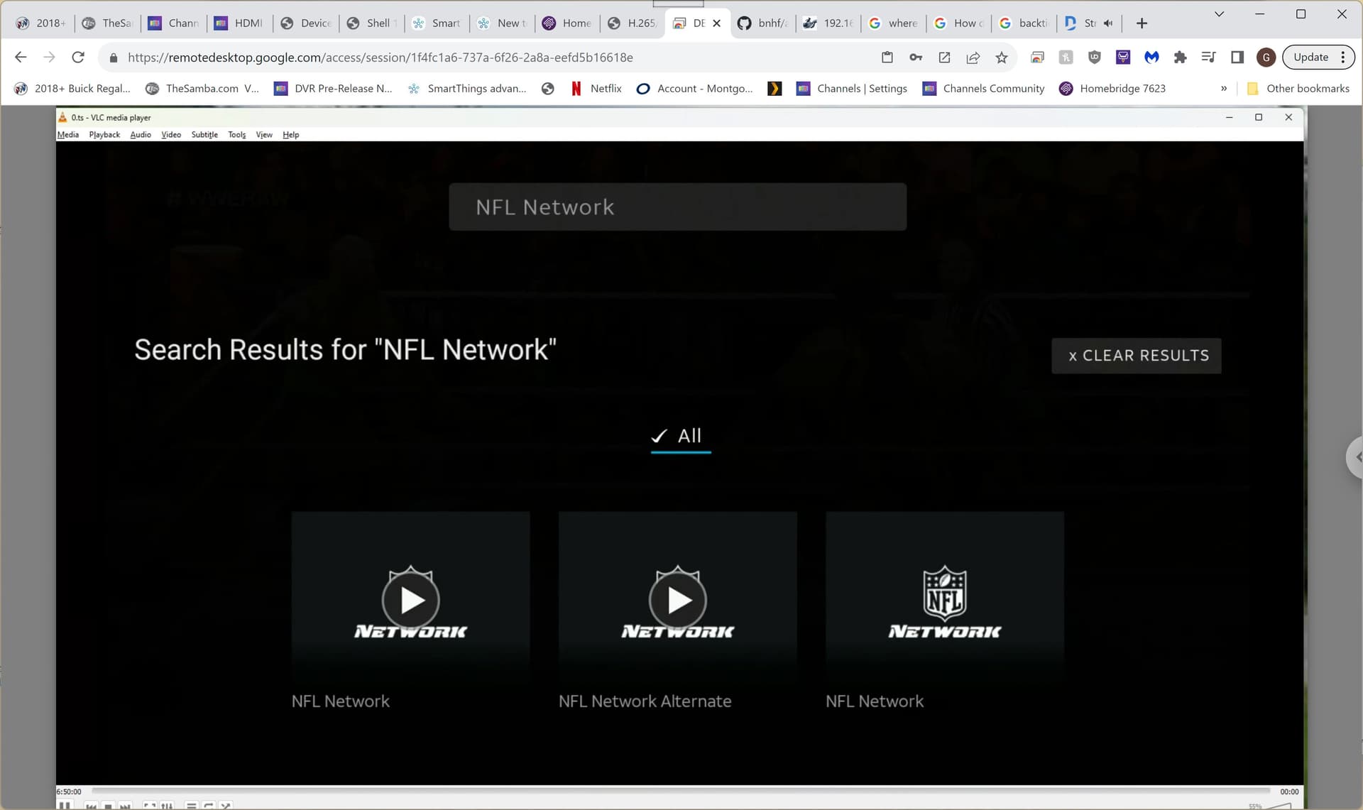

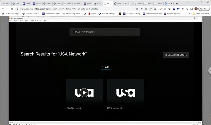

directtv guide looks like its USA Network in the black Banner and does not switch back from
NFL Network or vice versa. NFL Network HD is not found. it gets stuck at multiple choices.
two for USA one 3 for NFL Network
If I continue by click down 1 space and select it works?

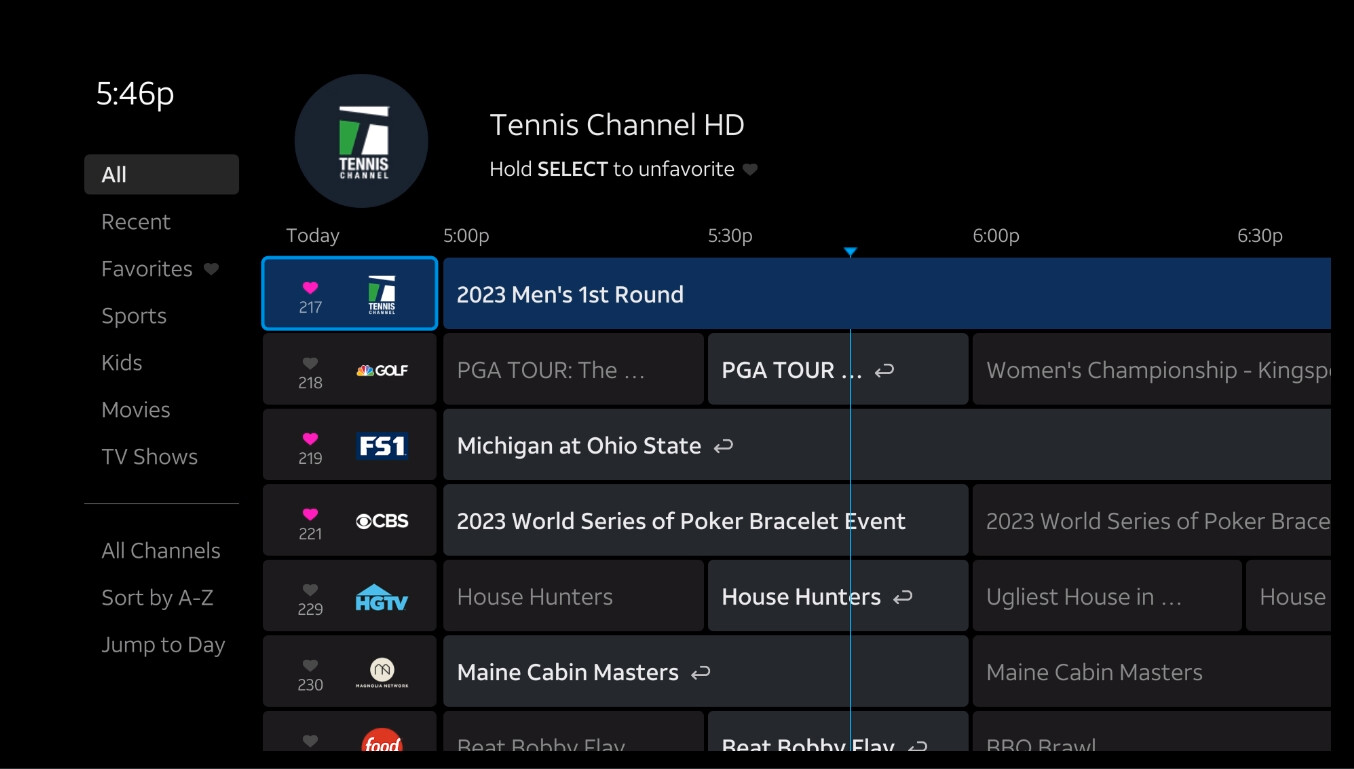

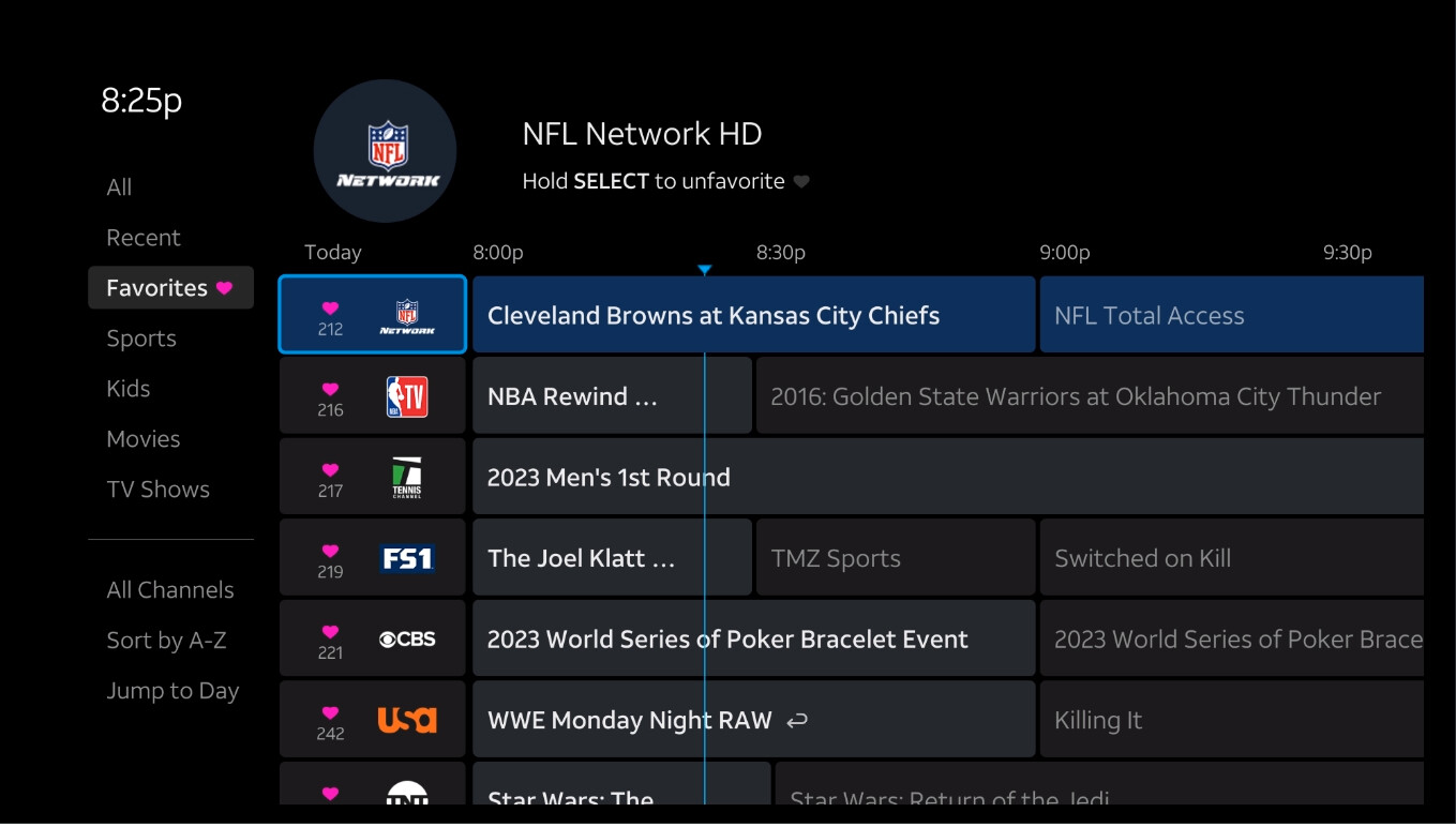

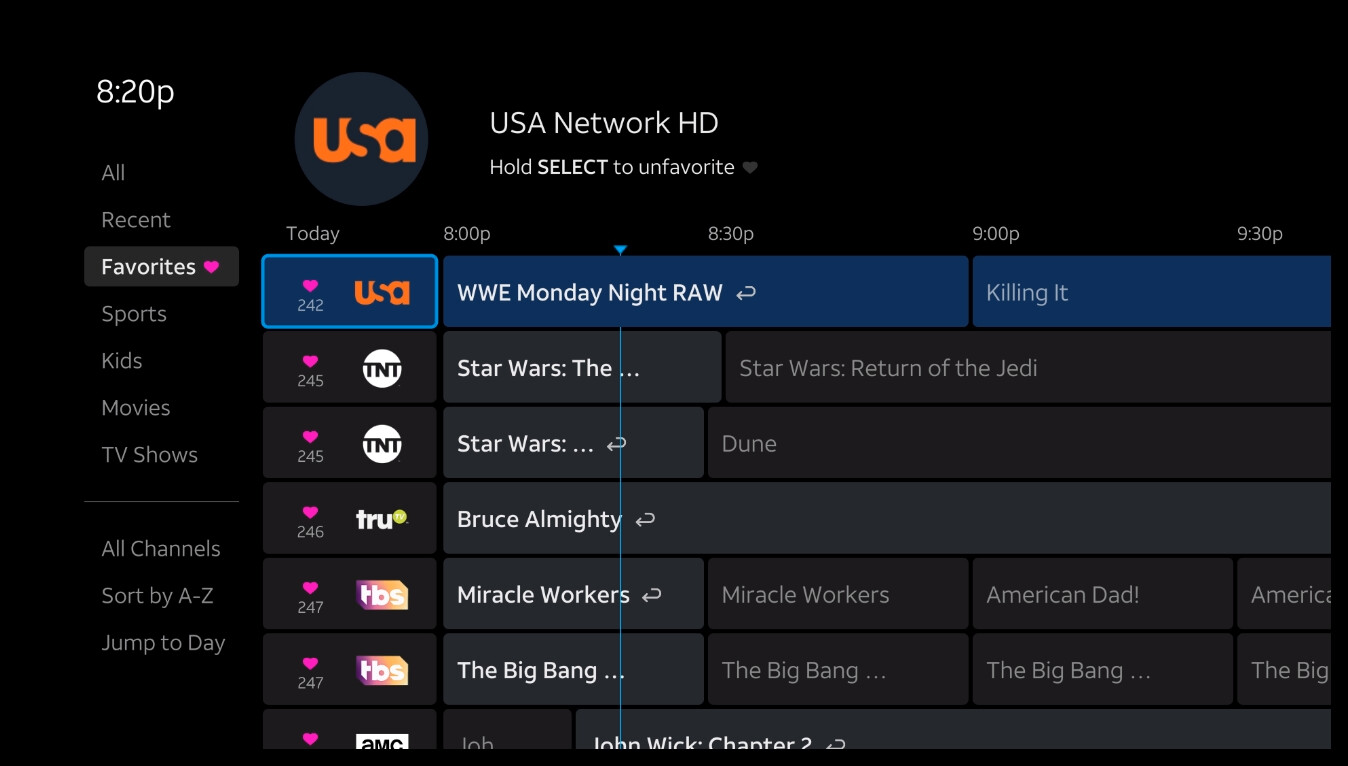

Neither of these are showing the HD part in the search box. Are you sure it's in the M3U? Hopefully this isn't another difference between our apps.
Here's a screenshot from my DTV app grid guide, and you can see for USA Network it should include HD:
As should the NFL Network, which also needs the HD:
You might need to do the "Reload M3U" in Channels DVR settings for this set of Custom Channels, and maybe even redownload the guide data after confirming the info in your M3U.
