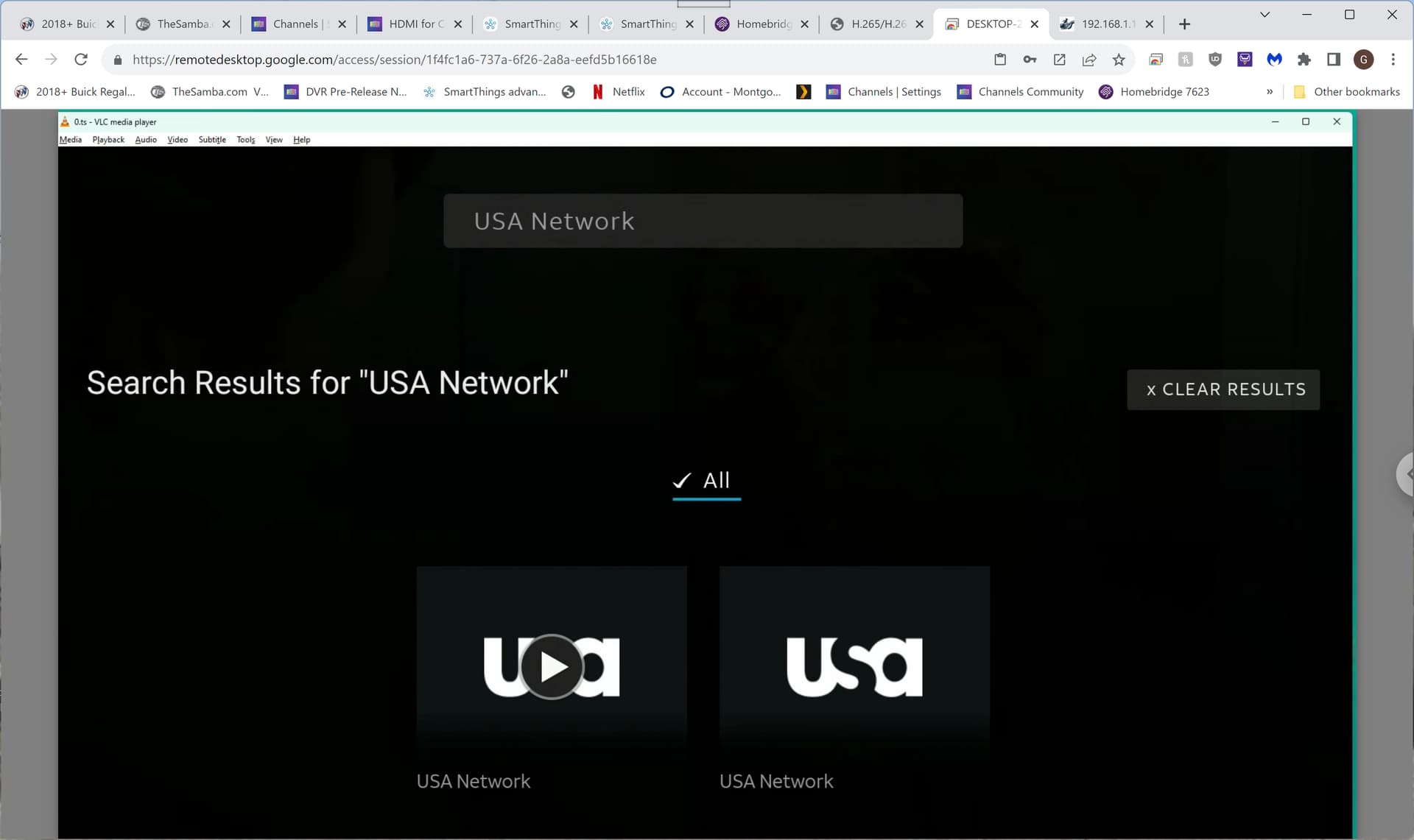

something is not quite right it appears to be somehow tuning from your M3U?
even though it looks right in channels? USA Network HD is not found should be No :"HD"
