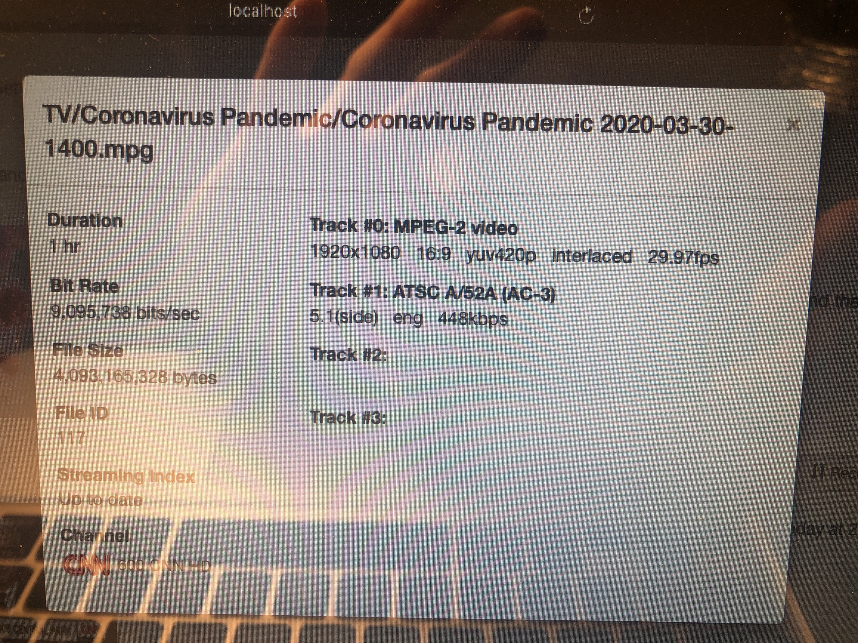

I went into the log on the actual DVR and saw the following for the show I recorded:
loc=1316 pkt=8 pid=6830 what="pat_and_pmt" offset=0 length=1504 contiguous=true changed=true packets=2

You need to check the Log tab of the DVR (top right) and look for the [SNR] message.
Or you can click View Details on the recording and it will show the errors in there .

If the recording you made shows pixellation when viewed on your ATV, try viewing it directly from your MacBook (or whatever your DVR server is) using VLC. Just open the recording file with VLC and play it.
Also, you should have the HDHR, DVR Server and ATV wired to the same gigabit ethernet switch at least temporarily for testing/troubleshooting.
Do you have issues with any other high bitrate channels (9+ Mbps)?
So many variables, need to eliminate some by troubleshooting. Could be CNN broadcast, cable signal, HDHR, wifi, etc.
