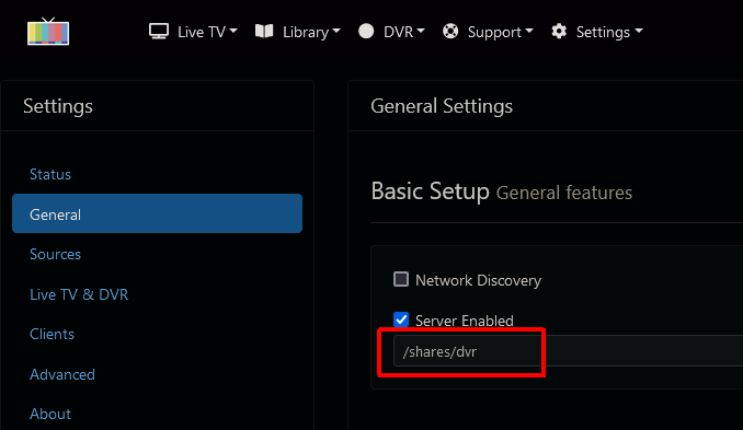

What is the recording directory you picked in Channels DVR? (case sensitive)
Screenshot 2024-10-13 at 14-37-36 Channels Settings

How do I know that (experience /shares/dvr ≠ /shares/DVR).

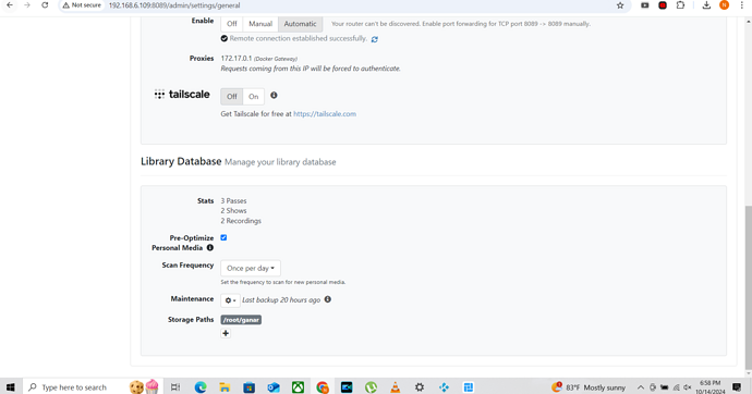

As you can see in the picture the server does tell me what the path is but as you can see in the next picture that path is no where near to be found anywhere on my NAS, the folder that I have that says recordings as you can see is open in the picture and it is a folder that I created a long time ago before I was using channels I was using tivimate and I would store my tivimate recordings the but as you can see there is nothing absolutely nothing related to any channels content on my NAS, I dont know why people keep repeating things to me that are already in the guides, Stop telling me things that are in the basic channelsdvr settings if those things were a fix I would note be posting this, as for where I told docker to store my recordings when I created the channels container? The answer is I didnt I just let docker use whatever default path it uses, which docker doesnt say. IM GOIING TO SAY THIS ONE MORE TIME SO THAT PEOPLE PLEASE STOP REPEATING THE SAME THING, this isnt a matter of channels not storing my recordings or a matter of channels telling me where my recordings are, like I said channels does tell me, THE PROBLEM IS THAT THE LOCATION THAT CHANNELS TELLS ME CANNOT BE FOUND ON MY NAS of course its on there, I just have not way to see it, PLEASE UNDERSTAND !!!!Thanks in advance
as you can see that location isnt showing anywhere on my NAS

You have Channels DVR recording to /root/ganar in the Channels DVR docker container.
Where did you volume map that to on your NAS?
You're also using a bridge network for the container instead of host network. You probably can't see the Channels DVR Server with any Channels client app because of that.
First of all I never said I understood docker, because I dont, what I said was that YOU dont understand docker, I have no problem saying that I dont understand Docker thats why I am asking the question in the first place what I am saying is that your failure to understand the question as it seems, shows that neither do you, as for how installed docker I downloaded the following image on the picture I will post and after I ran the image I just kept clicking next on the installation/configuration windows that came up, until it finally started running.
