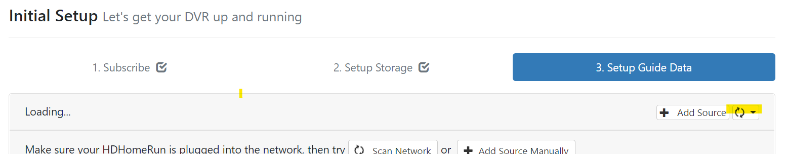

My DVR service is out of service. My setup was okay years. After encountering an issue, I rebooted my nuc. When viewing the admin page I see Channels is attempting to load the sources, there is a spinner. The source is an HDhomerun, I have no expectation that it will succeed because it has been way too long. I am not how troubleshoot.
Channels runs on nuc. Hardwired to router. Hdhomerun is hardwired. Both device are visible in Router app. Hdhomerun status page looks good. My nuc has internet access. I turned off the firewall even though port 8089 is open. But Channels app cannot connect. I tried my iPhone app and my firetv app.
I am lost on what to try next. Does anyone have suggestions?
-jerry
See the Loading... and the highlight spinner keeps spinning. Well over 1 hour now.
I also tried to manually add the HDHomerun source. Channels remained in a Loading state.
