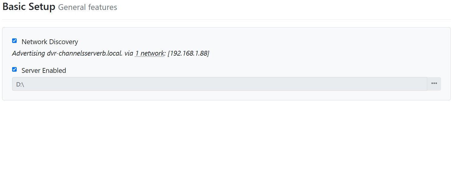

What do your settings look like?
Did you have any Imports other than what's in D:\Imports?
What settings? The ones for my Personal Media under Sources? They don't have the "new" named D:\imports\Tv or \Movies or \Videos paths added to them at all. I DO have other personal media on network drives that are mapped there, but none of them are in a folder called "Imports", like they are on the former RP drive.
Should they be added there? I never added them when this drive was on the Raspberry Pi, it just magically found them, or however it did, I never paid attention to that at all.

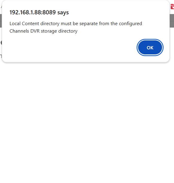

IF I try to map them, I get this:

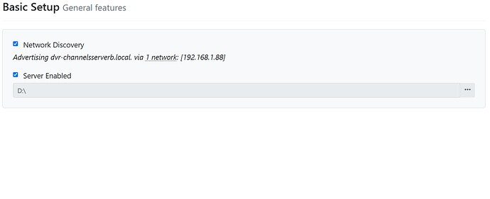

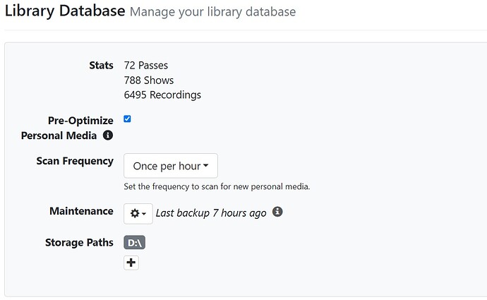

General > Basic Setup

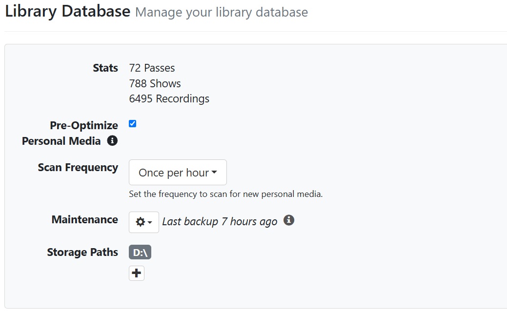

General > Library Database

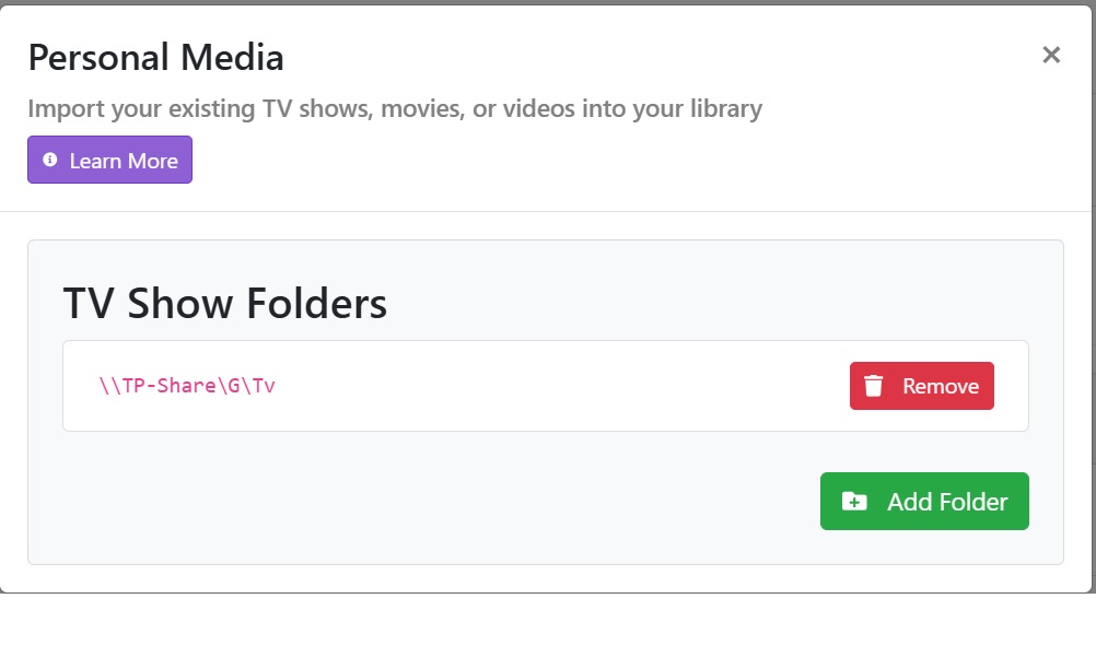

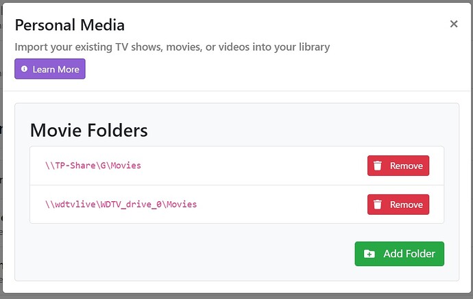

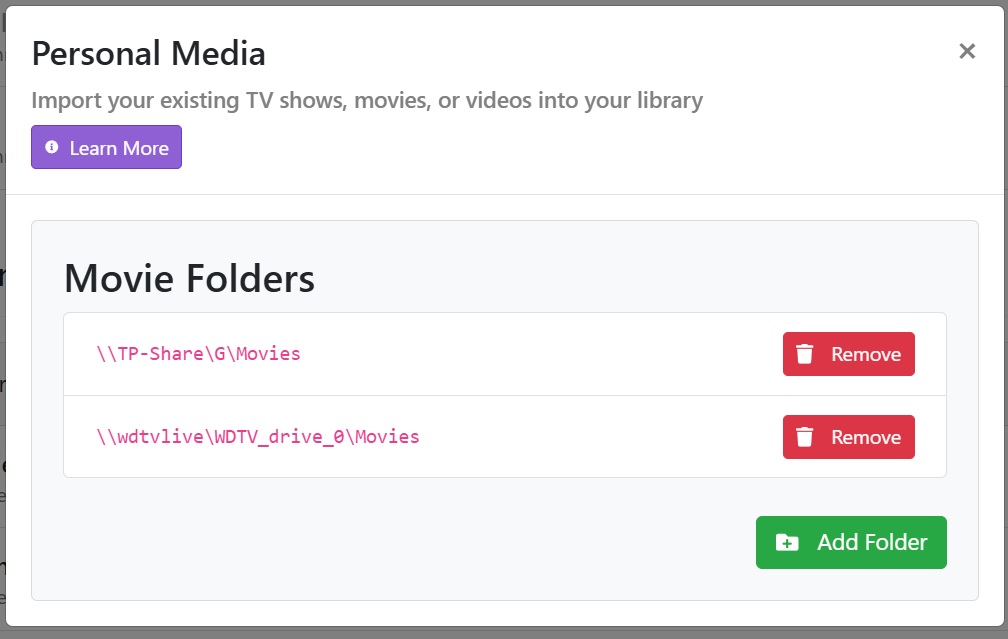

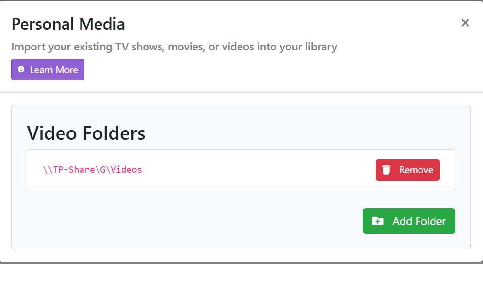

Sources > Personal Media
All looks normal.
So none of the duplicates you see are also in \\TP-Share or \\wdtvlive ?
Correct.
