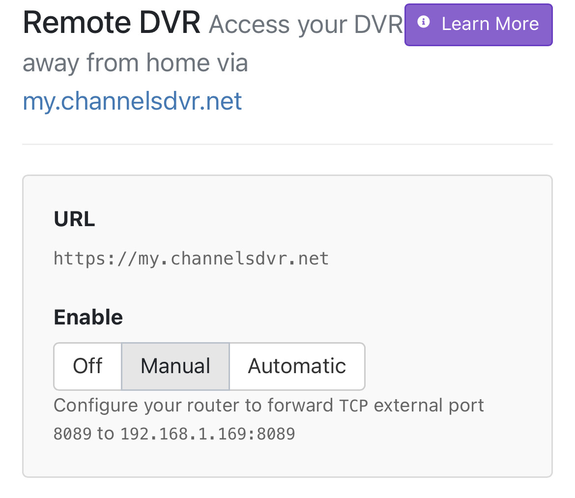

Hello to all as you can see in the picture i will attach below i am changing from my current internet provider (xfinity) to att fiber, and of course my entire ip address will change not to mention all of my configurations, I was just curious as to what, if anything I must do to get channels working with the new ip address, do i just input my new local ip address and end it with :8089 and it will start to work like nothing ever happened or must i reinstall or stop and start channelsdvr or anything at all? thanks in advance!

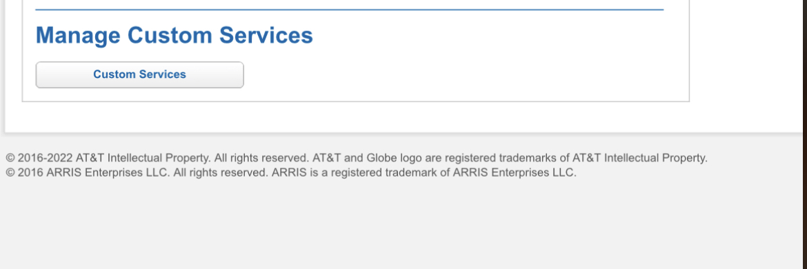

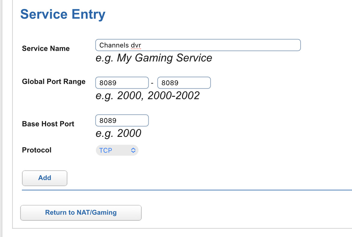

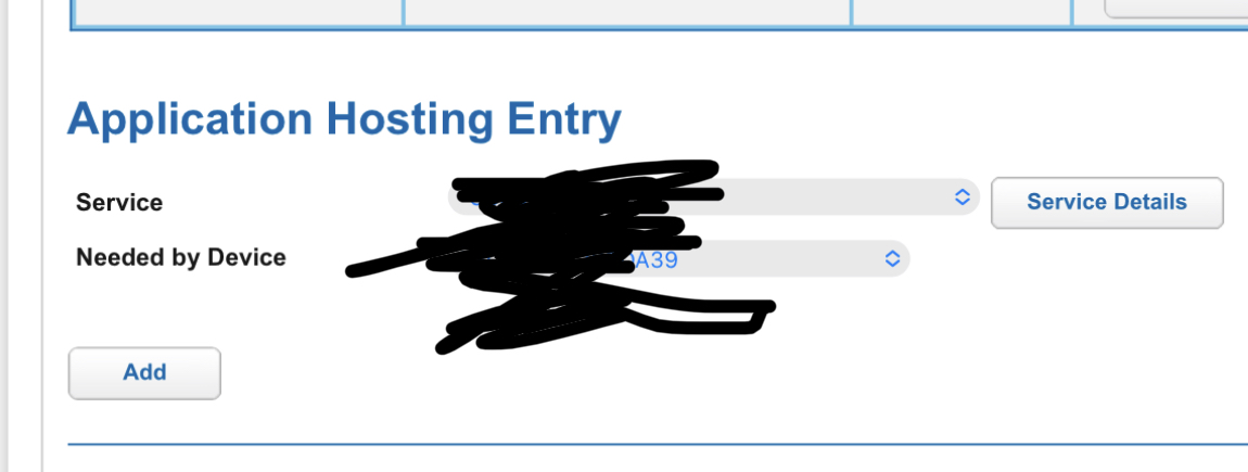

If you want to enable remote streaming ability you need to port forward 8089 to the new ip of the server. They will probably give you a bgw320 router. Here is a guide on how to port forward that router.
thank you so much brother you are a lifesaver
