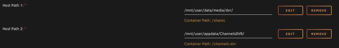

My docker volume mappings are:
/shares > /mnt/user/data/media/dvr/
/channels-dvr > /mnt/user/appdata/ChannelsDVR

It looks like your mappings are backward. The options in the Docker command should be:
-v /mnt/user/data/media/dvr:/shares/DVR \
-v /mnt/user/appdata/ChannelsDVR:/channels-dvr \
Of course, it doesn't matter where you mount the DVR directory (mine is at /dvr, but the /channels-dvr mount is the most important.
Apologies, I wrote them down backward because I was in a hurry. They're mapped correctly in the Unraid GUI, it just displays them backward for some reason:
