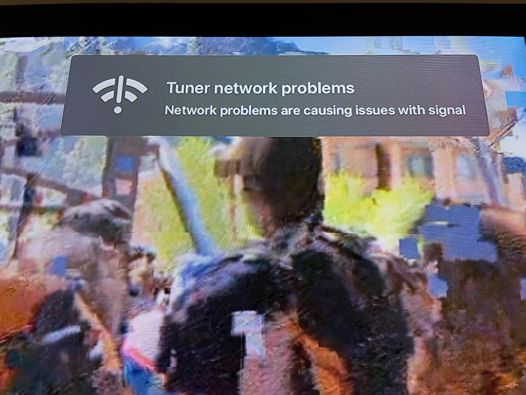

So I'm not sure if this might be part of the issue, but, I"m also running the HDHR into a Netgear 100/1000 switch. The switch also has my Mac Mini connected to it. The reason for this is because I'm renting my modem from Cox and the fiber modems only have 2 data ports on the back. Could this be causing the issue? Should I buy a compatible modem with enough ports to bypass the switch or is there a better switch I could get? I got the business-grade Netgear. What is leading me to believe it may be the switch is that I noticed on certain channels like PBS I keep getting a warning in the top right telling me there is a network issue (see pic). My channels also dropped from 117 to 110 after rescanning. But the signal strength and quality on the channels is great. I wonder if I have too much going on for the switch?
It's better to use a dedicated switch like you have. The router built-in to the modem is worse.
It is unlikely that you would be overloading the switch. Could be a bad cable or something else.
Try the official HDHR app.

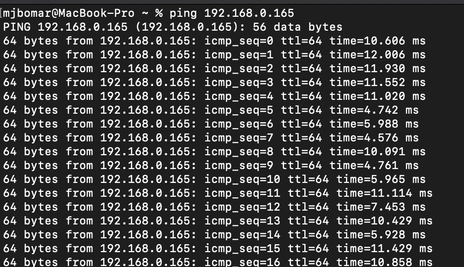

Huh that’s odd. Can you do a ping test from the Mac to the HDHR IP address and see if you’re seeing any packet loss or anything? Something odd definitely happening.

I did ping it:
He said his atv is wireless

This looks like a MacBook Pro, not the mini. I was hoping to see the test from the server to the HDHR.

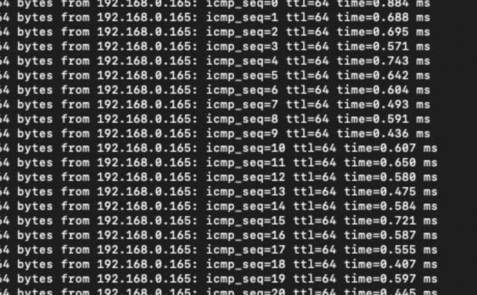

@Macnbaish here is from the mac Mini
That looks good and what I would expect for a wired connection. You mentioned the HDHR app on the Apple TV shows no issues. Do other clients play the channels OK? You could install the app on the Macnbaish mini and test them there, for example. Just trying to narrow things down.
