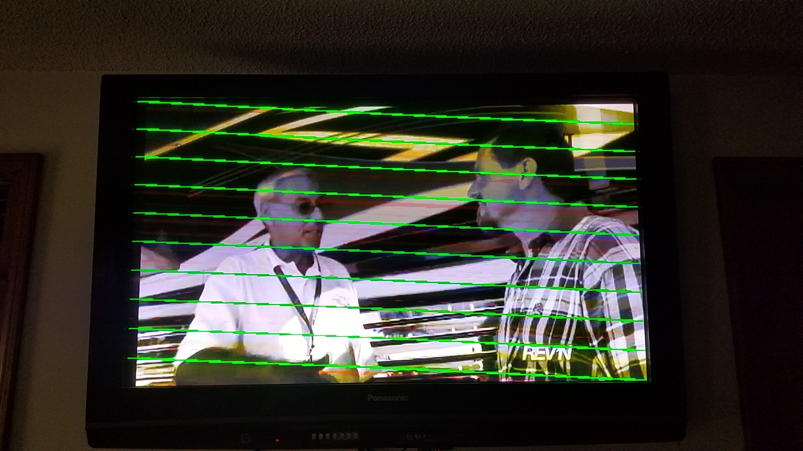

I get green stripes on one set of channels only. I believe![20200623_105730|690x388] the issue is with the Channels app as the HD home run plays them just fine any ideas? I am running the server on a Raspberry pi 4 2G.

I just switched from the Raspberry pi server to my old Minis Computer server and the lines are not there so it must have to do with the Raspberry pi . is there anywhere that lists the best settings for my server. also I have the Home Run Extend's Transcoder turned off.

I don't think changing servers should have made any difference.. is the app set to Settings > DVR > Home Streaming: Original ?
it is a HDHR Local channel And it is only the one Channel (Including all of its subchannels)
I just switched settings to Original (from 720 3mps) and that solved it
