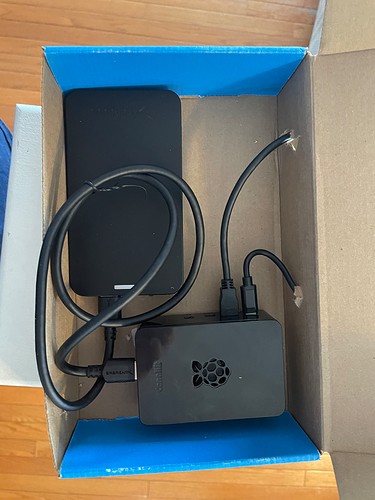

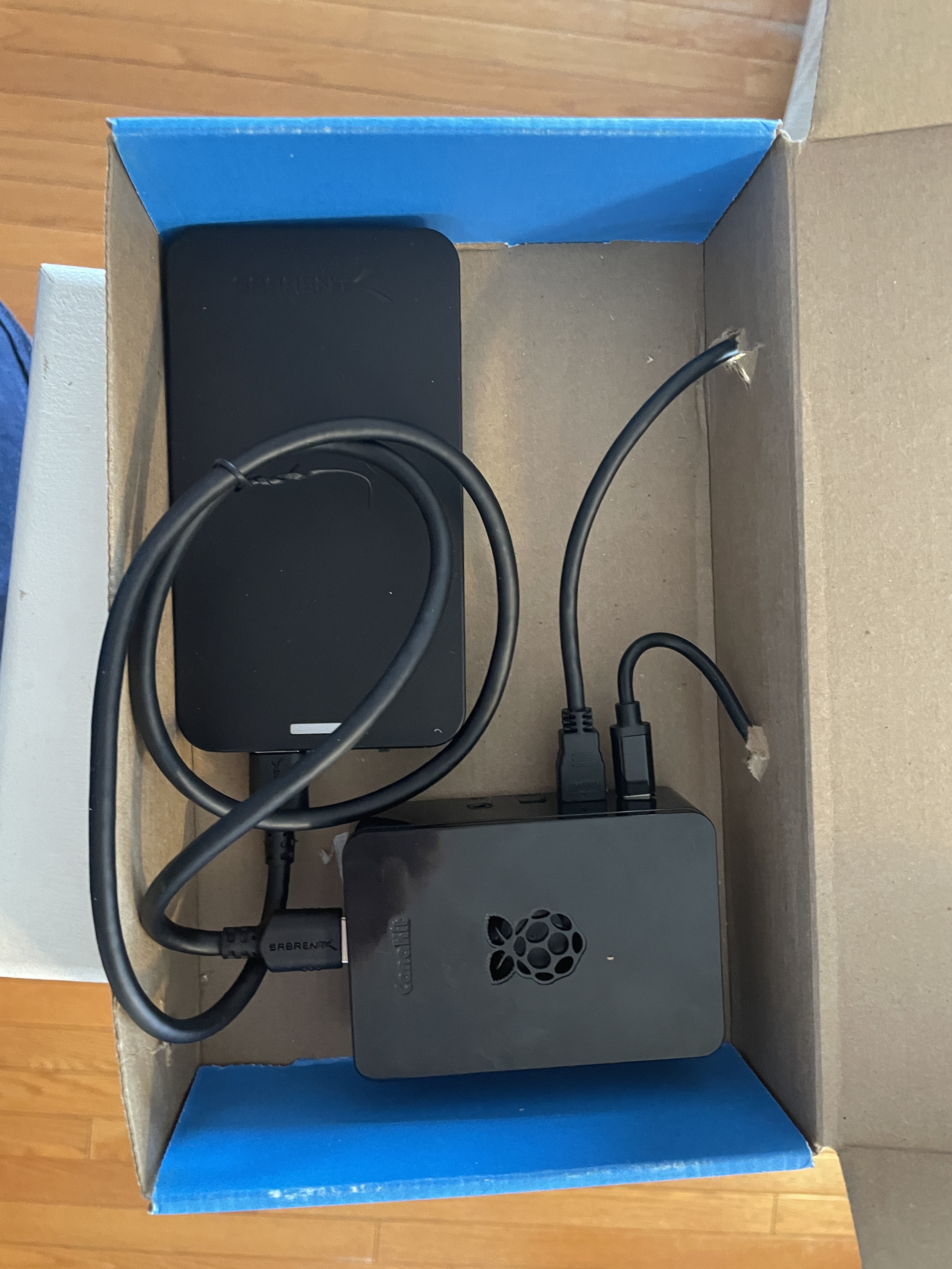

Does anyone know of a housing that can contain both the Raspberry Pi (already in it's own housing) and the USB hard drive, and maybe even the Homerun device as well. Right now they are all discrete units. but they are all small and would benefit from a one piece case. I am going to put them all in the Cardboard Canakit box that the RP-4 came in and make some vent holes for cooling.

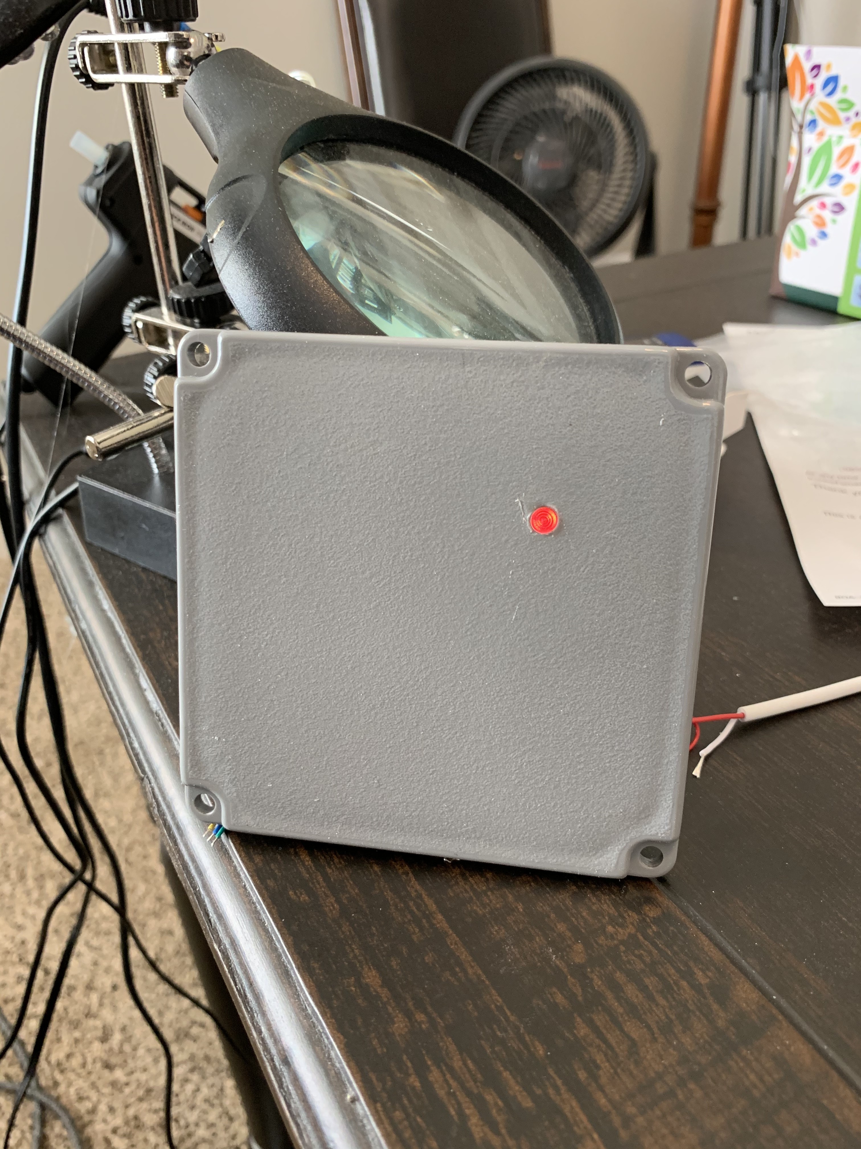

There are lots of project boxes on Amazon in all kinds of sizes. You can likely find one that will contain all your devices. As for making the LEDs visible, search Amazon for “light pipe”. They come in various sizes and lengths and conduct light kinda like fiber optic cable.
Here’s a project I did using a light pipe.

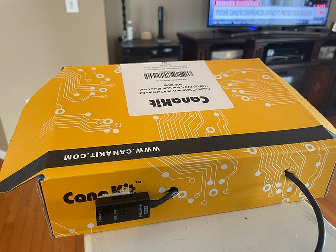

Yean I saw a bunch on Amazon. Looks like Bud industries has the best pricing and selection. I went to their site directly. Thanks for the light pipe recommendation. BTW your image is not visible on my computer, but that might be my issue, having internet problems with xfinity. Im going to switch to my 5G Hot Spot to see it that is where the problem is. I'll post a picture of my cardboard box solution when I get that sorted

Looks functional. A couple of things to keep in mind:
  1. Heat. Those Pi’s can get hot. Heat buildup can cause system crashes and worse.
  2. Speaking of worse, cardboard burns really well. The good thing about project boxes, especially the UL listed variety, is they are designed to melt long before they flash over and burn (plastic ones)
@psperry
The raspberry pi has a heatsink and a fan. Doesn't even get warm on the outside of case and I can open the lid and hold my finger on the heatsink and it is warm but not hot. I was surprised. But your point is well taken. This is a temporary solution. @maddox Not a spinning drive, it is SSD.
Found two on Amazon I really like One is a retro Nintendo box with the SSD being mounted inside a cartridge. Not meant to easily pull out, but the retro look is really cool, but since it will be hidden away in the laundry room will not be appreciated as much as if it was somewhere more conspicuous. That one was $39. The other one was $26 and practical. That one was from Geekworm X825-C8
