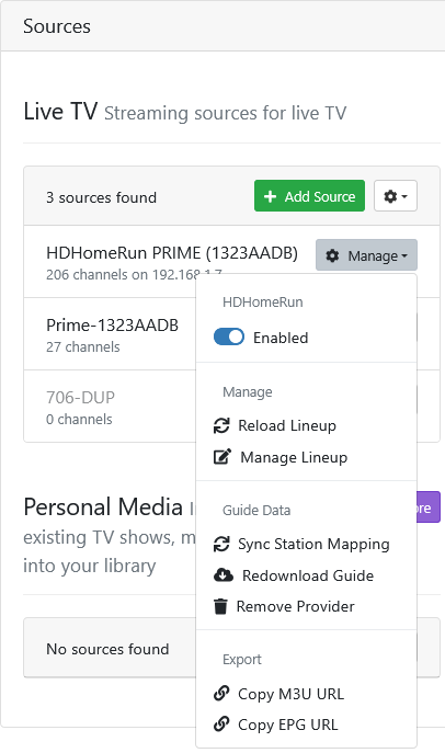

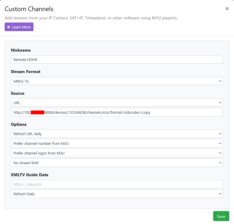

Setup Tailscale on your remote DVR device and local DVR device.
From your local DVR device connect to your remote DVR device using a browser.
http://tailnetIP:port/admin/settings/sources
Example: http://100.x.x.x:8089/admin/settings/sources

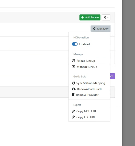

Click the :gear: Manage dropdown next to your HDHomeRun source
Click Copy M3U URL
On your local DVR, Create a new Custom Channels source
Choose Stream Format MPEG-TS
Paste the M3U URL you just copied from your remote DVR into the Source URL so it looks like this
You now have your remote HDHR Tuner available as a local source through Tailscale.
Make sure you have the available upload speed from your remote server and download speed from your local server to stream the number of channels from your remote HDHR Tuner.

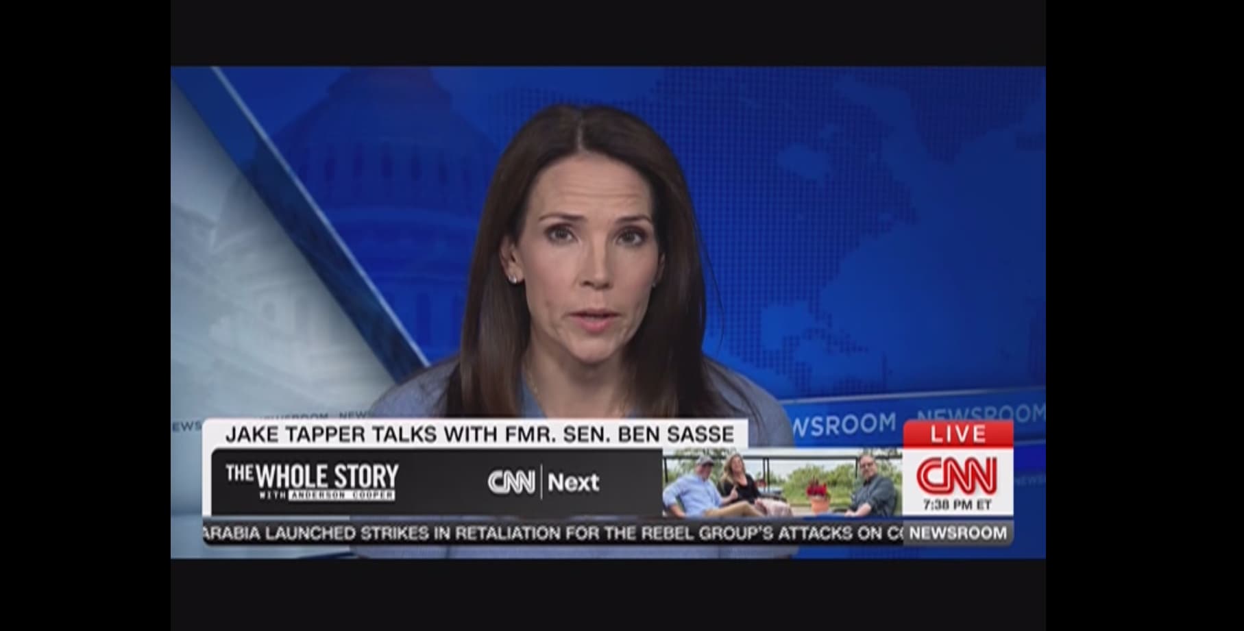

IT works !!!!!
Problem is it's not filling the screen . Almost there though !
****Video is 704 x 480 not 1280 x 720 or 1920 x 1080
*EDIT Fixed I chose a SD CNN instead of HD in Channel guide

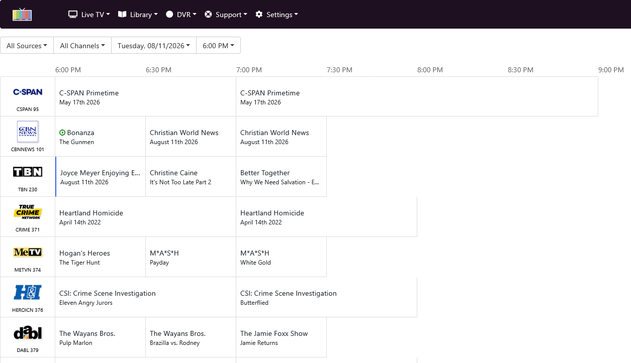

Fixed now. i did not select a HD CNNchannel, instead I had checked off a SD Channel but now EPG is only going out to 12 hours
Delete and Recreate the Guide Database
Settings > Live TV & DVR > Guide Data > Maintenance :gear: Delete and Recreate Database
Stay on that settings page until the Status shows all 16 days of guide data has been downloaded
Status Downloading guide data for 2026-08-11 1:30PM

Your local Channels DVR is the one that fetches the guide data and should be the one you run that Delete and Recreate Database on
I did it with where I am now and the remote location still nothing beyond 12 hours
Funny, on remote guide source it reads 338 channels whereas here 411 channels

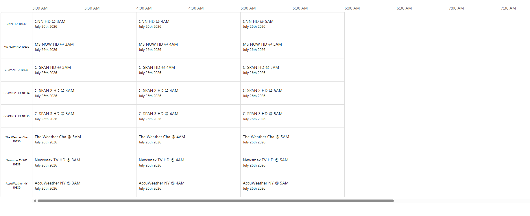

Check the DVR web UI guide
Live TV > Guide

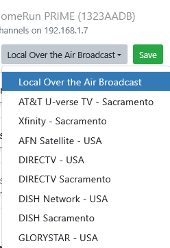

On your remote Channels DVR you need to setup the guide provider for your HDHR Tuner
Click on Pick Guide Provider
Screenshot 2026-07-27 at 11-26-19 Channels Settings
Then enter your Zip Code and click Search
Screenshot 2026-07-27 at 11-26-43 Channels Settings
Now select your cable provider
Screenshot 2026-07-27 at 11-28-34 Channels Settings
It will then load all cable channels and get 16 days of guide data.
Check your remote DVR web UI guide
