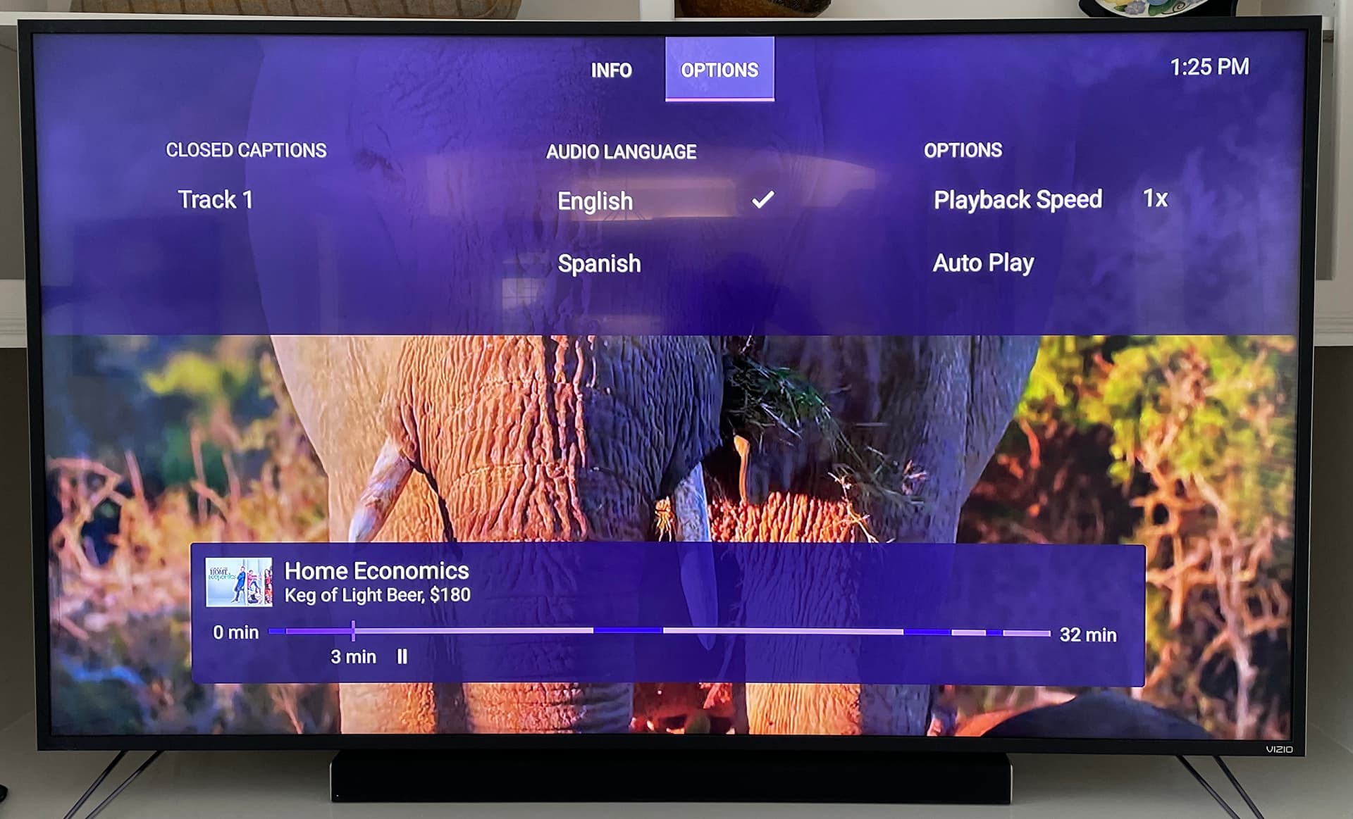

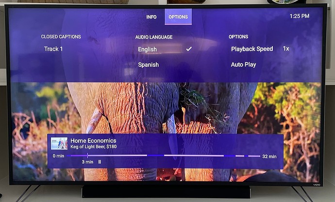

I’m changing the language in this screen (see pic) while the recording is playing.
While watching a recording, Press the bottom of the circle on the Firestick remote. That opens the info screen. Change the selection at the top of screen to options. Uncheck English, then select Spanish.
Funny, I had resorted to blocking the 4K broadcast also, but wasn’t going to be happy until I found a solution.
Like I said, on CBS recordings it’s the opposite. The English track eliminates the audio description. (That was my experience with a Young Sheldon recording)
