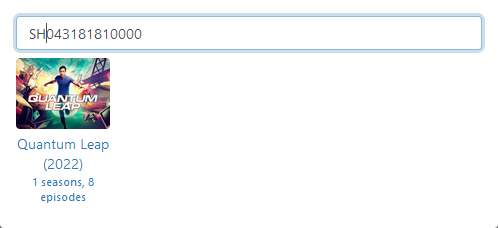

Channels DVR Series ID is 198595
Gracenote/zap2it/tms ID is SH008641910000
You can do a fix match on the show and put just the tms ID in the search box to match the show and artwork

  1. Go to zap2it.com
  2. In the search field, type in the name of the program you want.
  1. Select the version of the program you want. This is usually the one with the latest year, but not necessarily (YMMV). Pay particular attention to the episodes as whatever is in Zap2It is what is in Gracenote, which is what Channels will expect. You must match to the seasons/episode numbers as it is here unless you want to manual edit everything to match your files.
  2. Look at the address bar. The TMS ID is in the path:
  1. Copy the TMS ID and use it for matching in Channels

This is going to be convoluted, so stick with me.
  1. In your browser, go to https://[YOUR_SERVER_HERE]:8089/dvr/files
  2. This will be a beautiful view of every single thing that has been added to your DVR that has not been deleted. The lowest number on top is the most recent addition.
  1. In the block where is says "Filter JSON", type in the name of your program that has been recorded. This will filter the list down to records that contain that name.
  1. Note these numbers and take special care to make sure it is one of the episodes that was recorded, not one that you imported. Now, clear out your filter, navigate to that number, and expand it with the arrow on the left side.
  1. Expand Airing, then expand Raw, then finally program. Under program, you will find a record called tmsID. Note that this is the tmsID of the episode, not the series.
  1. Copy that and then go to your imported version of the show. Click on More Options > Fix Incorrect Match and paste that in the search box. In this order, change all of the last four digits to a zero if they are not one already. Then, change the "EP" at the beginning to "SH". If you do not do it in that order, the search window may close.
  1. Now you should be able to match and merge!
Note that you can also click View Details on the web UI and then click the number under File ID to see details
