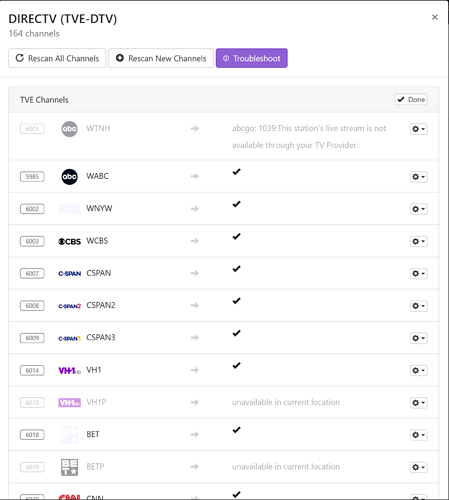

How often, if at all, does the server check the availability of TVE channels?
I mean what you see on this screen:
I know that if you have a scheduled recording on a TVE channel and the channel has a problem, obviously the recording fails. Is it the only time the server checks and reports that the channel is not available?
Or does the scan always have to be triggered manually at other times as shown in the screenshot?
