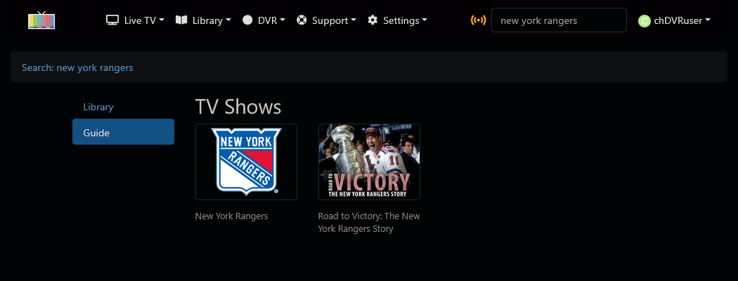

Trying to create a pass to just record NY Ranger games. Can someone help? Getting every hockey game!

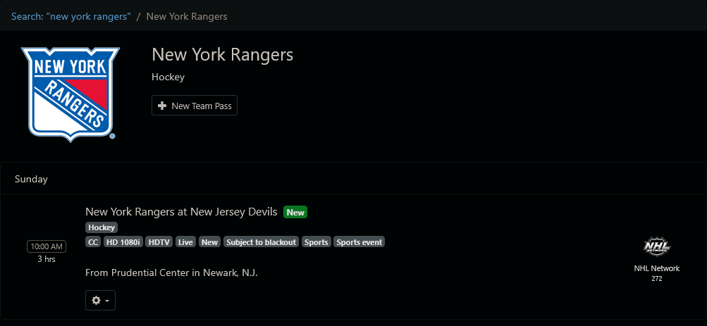

Go to Search section and search for NY Rangers. It should have results with the team logo and let you create a Team Pass

Thoughts on how to priorituze a channel as it is finding it on NHL Newtwork which i do not have, need to watch it on one of the MSG channels. Always had issue with TIVO recording the wrong channel. Think I can you set up multiple records based on a selected channel?
You can set the channel you want the pass to only record on, or you can utilize source priority and favoriting channels to hint Channels DVR Server at which channels it should choose first.
You will need to manage this on your Channels DVR Server, not your Channels app.
After making changes, view your scheduled recordings, and the channel numbers this airing is on, will be listed. Their order represents the priority order Channels DVR Server will attempt to record the airing on.
