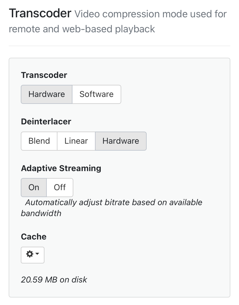

In your web UI for the DVR server, locate the Settings > Transcoder section:
If Hardware is an option, then QSV is being used.
How come I dont see Hardware as an option for Deinterlacer. running a macmini
If you don't see it as an option, it might not be available on your particular platform.
That option was there before I even had an Intel CPU (just got 4 days ago). Was using Ryzen 2600X prior to.
