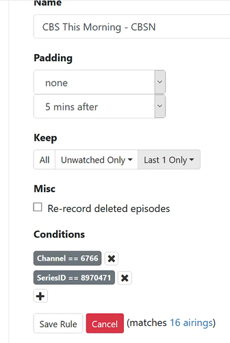

It won't let me set two identical passes for the same show. I didn't think of disconnecting my HDHR tuners. I tried that, it seemed to work. However I can't figure out how to record from OTA, and TVE selectively or at the same time.

Using what appears as an example, create a new advanced pass using the gear dropdown on the far upper right of the Passes tab to select New Advanced Pass
Now fill in the info same as your existing pass, but add Channel == your CBS or CBSN channel#

Doesn't show up in my Scheduler at all. Only the 505.1 (The custom tuner m3u) CBS. The CBSN one is totally missing. I double checked the custom pass too. It seems right. Here it is. It's now doing the same with CBS Sunday Morning. I have no idea what to do. It's like I have to either manually choose one or the other, or go without. It will not accept TVE, and OTA.

Show your advanced passes. Channels DVR uses SeriesID's and tms ProgramID's, not Title unless your pass specifies Title instead of SeriesID
I had it set up with SeriesIDs as well. But it didn't work. I've tried it both ways.
