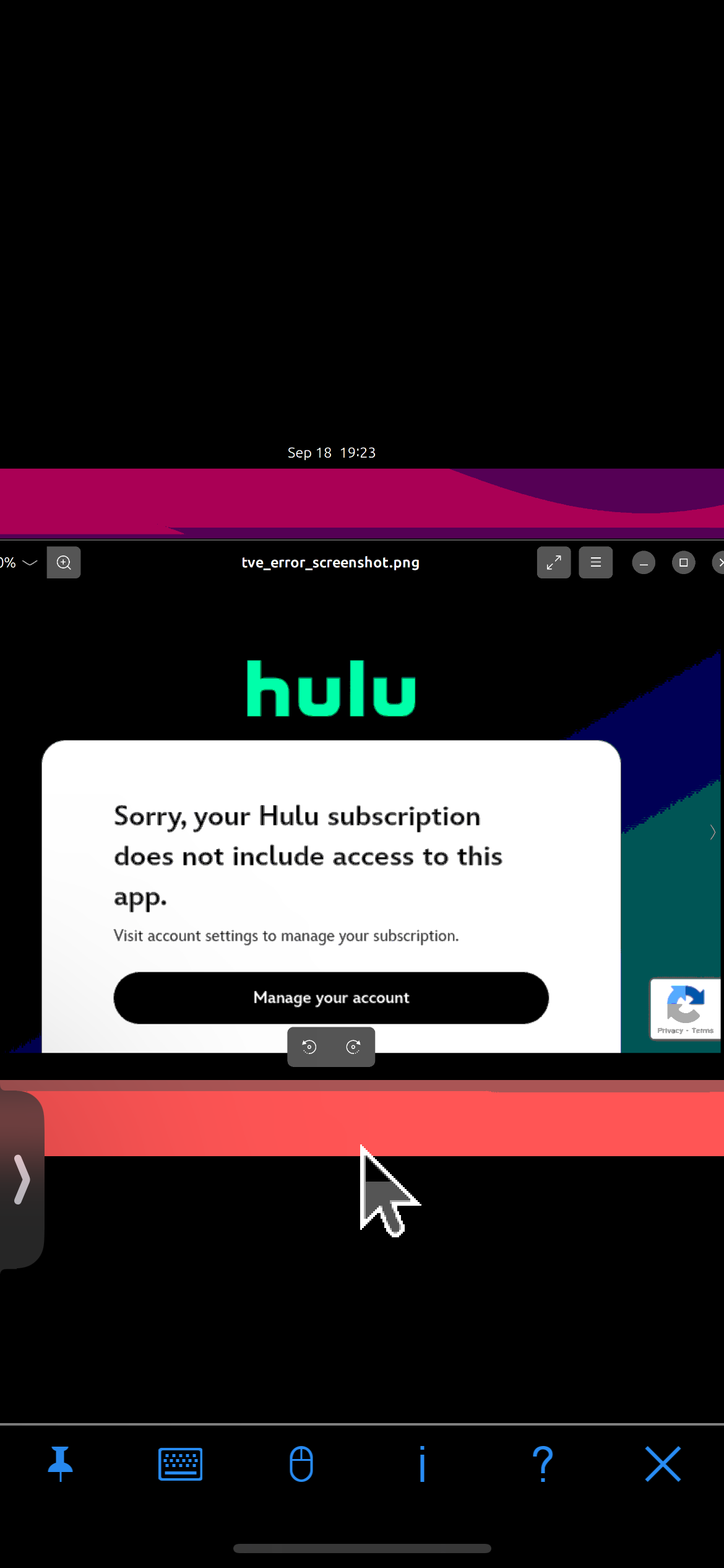

This is something different going on with FS1 fs2 and big10. I’ve never seen an error screenshot like this.
@tmm1 @eric @maddox diagnostics submitted
8c37ff13-4da6-4d87-9be3-fcea902ceeed
Are you able to login and watch with Hulu credentials here Fox sports
I get weird errors on the site but I’m trying on a mobile device
