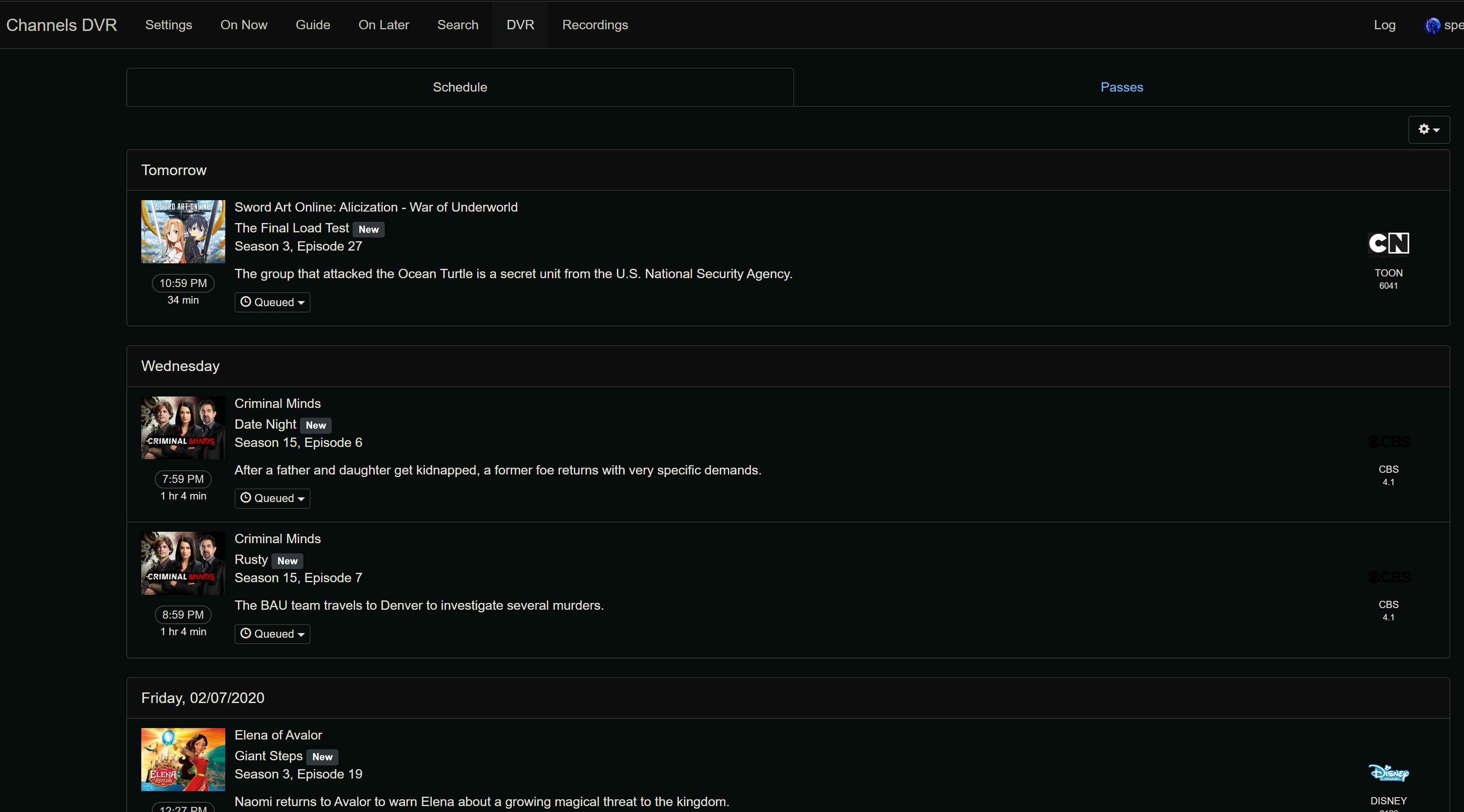

Works fine here. (though mine is set for New eps only)
If there are no eps shown in Scheduled tab, then, there isn't any eps being aired i guess.

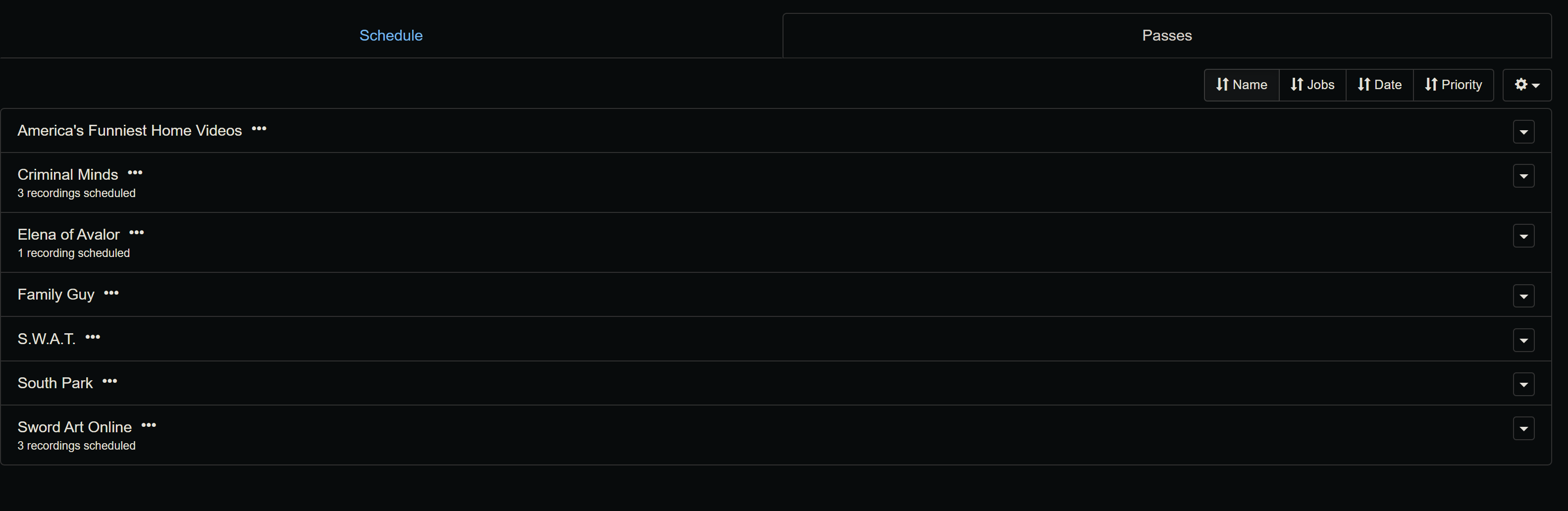

In the Passes tab, it shows how many recordings is scheduled for that show.

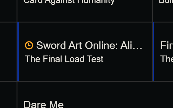

In the Guide, if a show is set to record, u see an icon next to it.
scheduled%20guide

For me, when i set a Pass, it schedules it instantly. I see it reflected in the guide.
I just set some random show as a Pass and to record all eps, and it showed 5 eps scheduled in both tabs. Also, it shows the orange icon next to the ep in the show.
