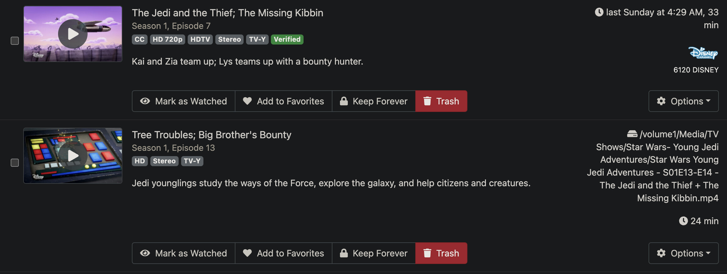

Well now I'm at a complete loss. I just ran a new conversion against a recent recording and got the following back from channels...
2023/08/01 22:00:00.818517 [ERR] Generating video index for file-12876 failed: No Keyframes were found in the stream
2023/08/01 22:00:01.047863 [SCN] Imported TV episode #12876 Star Wars- Young Jedi Adventures/Star Wars Young Jedi Adventures - S01E13-E14 - The Jedi and the Thief + The Missing
Using the same conversion process as the previous example (and dozens more like it), this file imported despite the missing keyframe. (Ignore the episode name and number discrepancy. This is expected in my environment.)

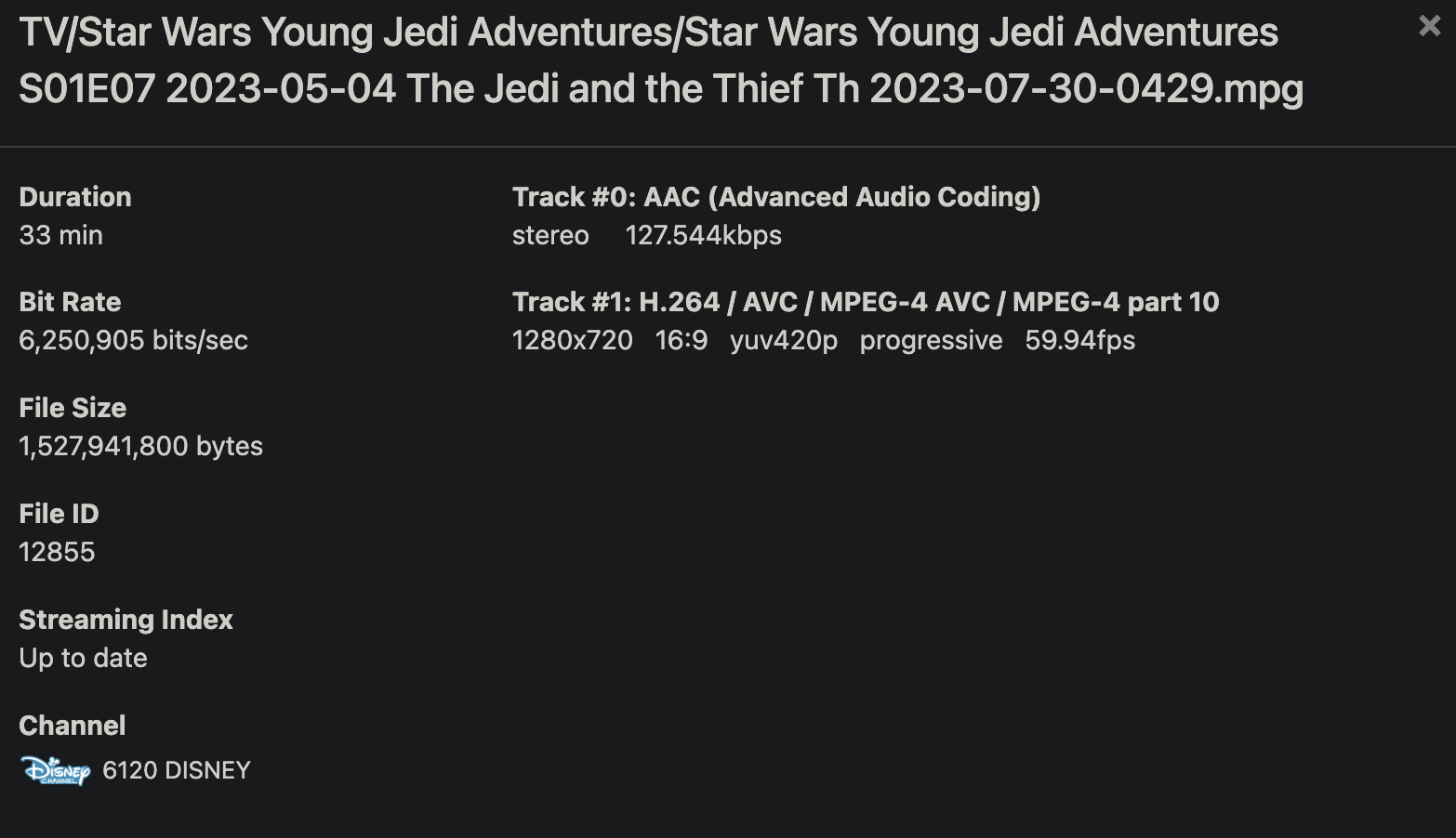

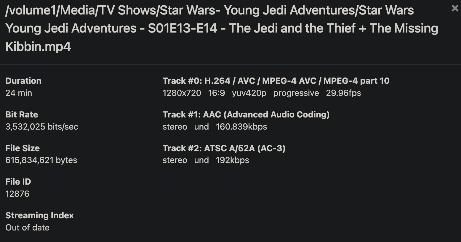

What does View Details show
Source File
Imported File
