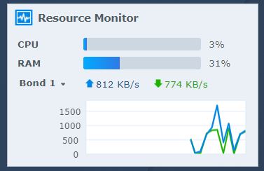

This image is just watching a TVE channel remotely.
This is not an issue that I experience, because I am not using TVE (no cable or internet-cable-equivalent subscriptions). But you guys are all missing the point displaying resource monitor and talking about drives.
OP is saying this:
- tune from HDHR = fast
- tune from Pluto M3U = fast
- tune from Stirr M3u = fast
- tune from TVE = takes a few seconds
The reason is because more backend things need to happen to tune TVE. It could be an issue with the account OP is using. Can it be sped up further, I don't know...
