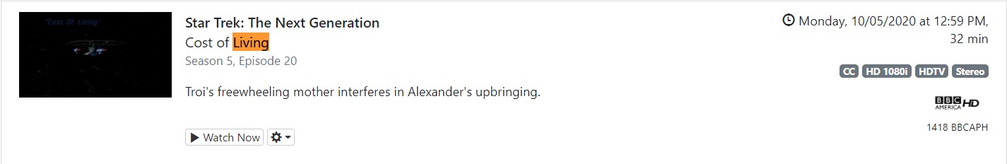

I am going through my recorded movies and am seeing a few not completely recorded but yet no failure is logged. Maybe a check of duration vs actual duration recorded. I deleted them so they will re-record.
I see it says the streaming index is out of date. If you do the “refresh timestamps” (not sure if that’s the exact name) on the recording does it fix it?
Did that not change ... the file size is way too small anyway for a 2 hour movie. I will blame it on Gremlins. ... but there should be some kind of indication when a movie only records 32 minutes ...

The problem is that you do not know when something is wrong until you go to watch it. There has to be some kind of alert I do not have the time to check every movie... or recording. I am afraid to look through my passes where I want all episodes.

Here is another one ..... No error or Interrupted. 32 minutes. Yeah but I am used to the Sagetv DVR notifying me of a problem when I start the Client.
