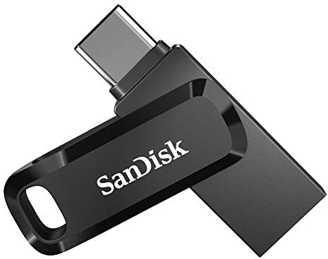

I noticed this behavior when using UBS2 thumb drives. Make sure you are using a USB3 drive, and preferably one with a built in USB-C connector, because an A-to-C adapter can introduce additional issues.
I use this one
Also I always uninstall then reinstall after channels after I set up the usb drive. I never had an issue and get a 2 to 4 hour buffer depending on source of channel.
@Tom_Leach no performance issues running Channels app from this drive? I was using an SD card with an adapter and it seemed to introduce some "jitter" into playback - it didn't cause app crashing, just what seems to be some performance degradation. Thanks.
