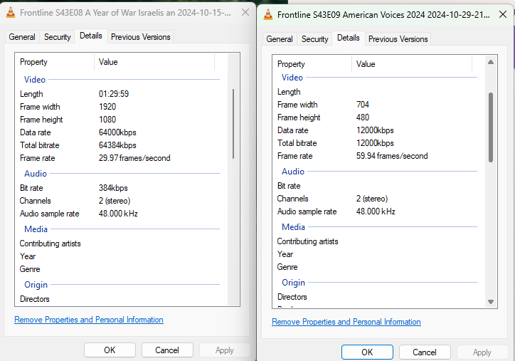

Yes. I tried several different programs including VLC. It wouldn't play on any of them. I also tried a different random recording and it played just fine on all the programs I tried. Something happened with this recording, but I don't know what and I don't know how to fix the file, if that's even possible. Since the file is over 4GB, I'm sure the recording is there, but something is missing or corrupted that prevents it from playing. While other files show a preview image, this one does not.
When I look at the properties it doesn't have any length and all the details seem incorrect.
Looks like it's an SD recording (704x480pixels).

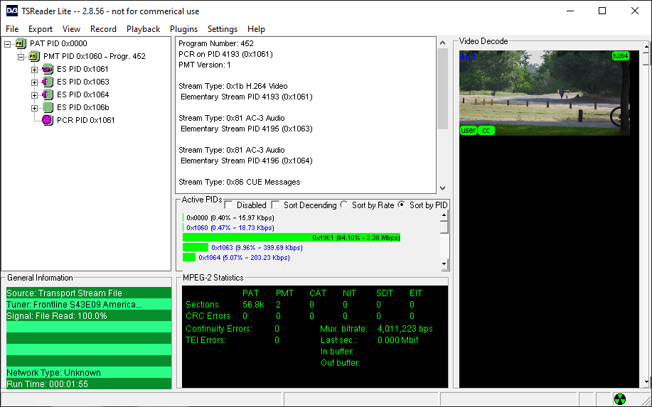

Can you open the recording in TSReader Lite Download TSReader Lite
Sounds like something may have glitched in the HDHR when it started the recording. What's interesting is last night I recorded back to back shows in PBS. The first show glitched, the second show recorded without issue. I ran the one that failed through ffmpeg and got the exact same results as the other file.
