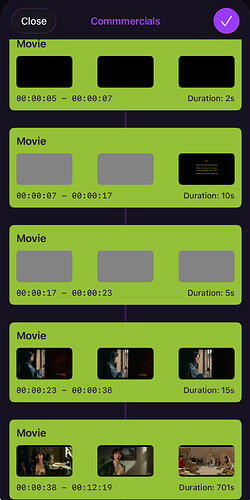

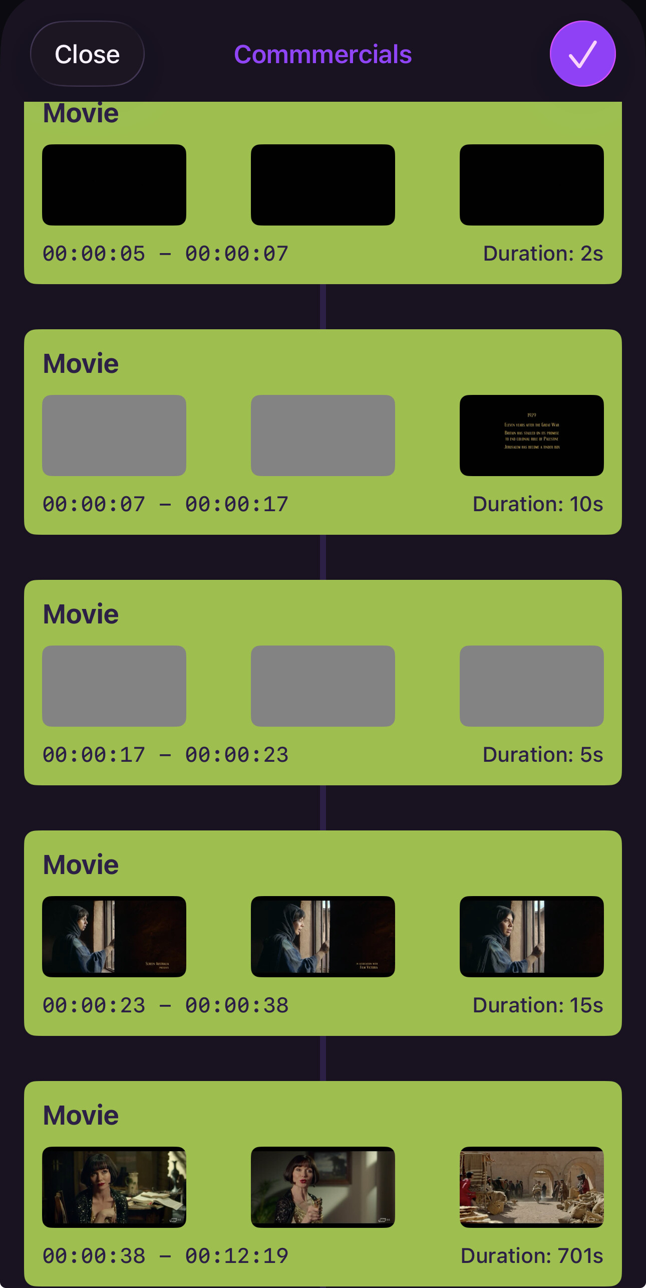

@tmm1 and @chDVRuser The gray screens are permanent in the recording. They appear regardless of where I watch, and they always appear at the same location. I did a short screen recording, but I can't share that here. So I'm attaching a screenshot of the Commercials editor where you can see them during the opening text. The are another 3 seconds in the middle of the movie that are gray, and then most of the rolling credits at the end have the same issue.

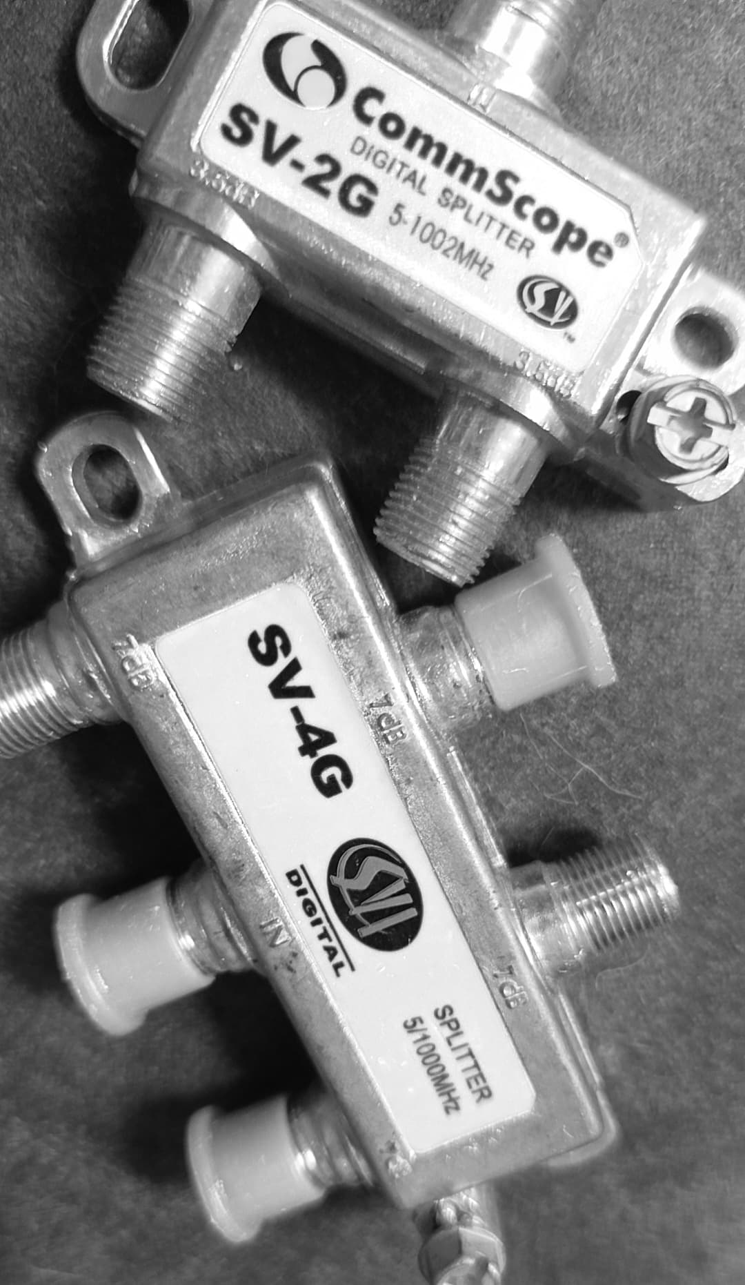

since splitters are relatively easy to find anywhere I just wanted to point out for those that don't know that a splitter does attenuate and most will be labeled how many dB's.
hard to get them to show up in a picture, but 2 ways are usually 3.5dB and 4 ways are usually 7dB.
find the dB that works for you and then you can order the correct one.
