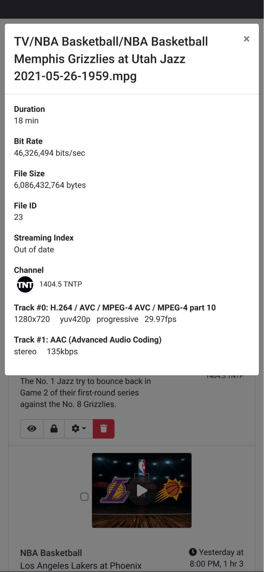

Interrupted recordings duration is wrong
I posted a few days ago about recordings being interrupted. There seems to be an isp issue. However, until that can be remedied I'm hoping this related issue can be fixed.
As you can see above, the duration is 18 minutes. However the game is an hour or more in. It seems like each disconnect, the duration gets started over instead of pulling from the entirety of the file. This didn't used to happen on blipped recordings.
This causes a problem with trying to move back & forth on the client side. If the file gets played through without trying to skip, the whole file is there, except for the blips that got cut obviously. However as soon as I try to skip through a commercial the spot if the recording goes nuts and causes it to jump around in no coherent order.
Version - 2021.05.26.0056
Diagnostic log - a839f266-2252-4b32-8232-d87be4cbec82
