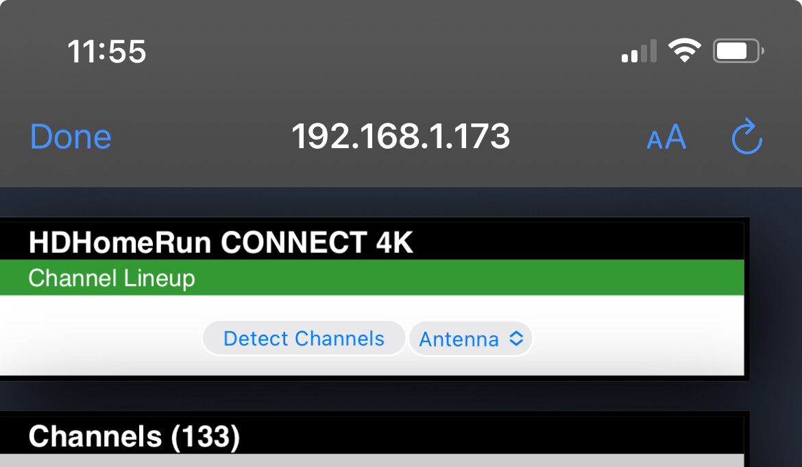

Is your hard drive getting close to being full? I've noticed I get a lot of interrupted recording errors whenever that happens.
You might try the ATSC1 equivalent of that channel. ATSC3 is still a science project. I actually disabled all of those channels in my environment. Always a hassle and no added benefit for me.
These errors show that the HDHR tuner was not sending a stream to Channels DVR
2024/09/28 22:05:13.168214 [TNR] Cancelling stream 1080A55D/0 ch103.1 after no data was received for 6s
2024/09/28 22:05:44.934575 [TNR] Cancelling stream 1080A55D/0 ch103.1 after no data was received for 6s
2024/09/28 22:05:55.557305 [ERR] Failed to start stream on channel 103.1 via 1080A55D: HDHomeRun: No Video Data
2024/09/28 22:06:16.618254 [TNR] Cancelling stream 1080A55D/0 ch103.1 after no data was received for 6s
2024/09/28 22:06:27.707386 [ERR] Failed to start stream on channel 103.1 via 1080A55D: HDHomeRun: No Video Data
2024/09/28 22:07:20.379186 [TNR] Cancelling stream 1080A55D/0 ch103.1 after no data was received for 6s

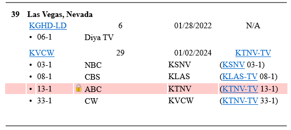

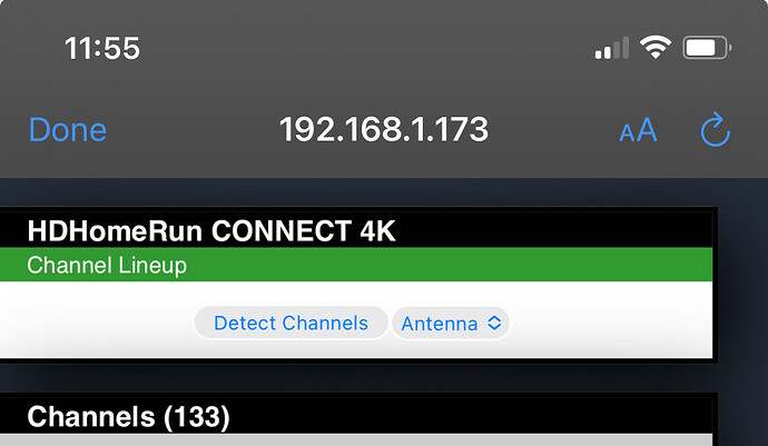

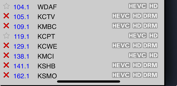

Most atsc3 nbc channels are drm’d. Can you even watch channel 103.1? Click on the ip beside your Hdhomerun under sources and then select channel lineup and scroll down to see if it is drm. Channels can’t play drm.
It's not DRM, but his ABC is
Screenshot 2024-09-29 at 10-10-07 RabbitEars.Info - ATSC 3.0 List
2024/09/28 20:28:01.457382 [DVR] Recording for job 1727580480-4 from 1080A55D ch103.1 into "TV/Saturday Night Live/Saturday Night Live S50E01 Jean Smart Jelly Roll 2024-09-28-2028.mpg" for 1h39m59.999613855s
Recording for 1h39m59.999613855s i.e. Recording until 22:08:01
Since the Season Premiere aired from 20:29 to 22:03, your pass scheduled it for 20:28-22:08
