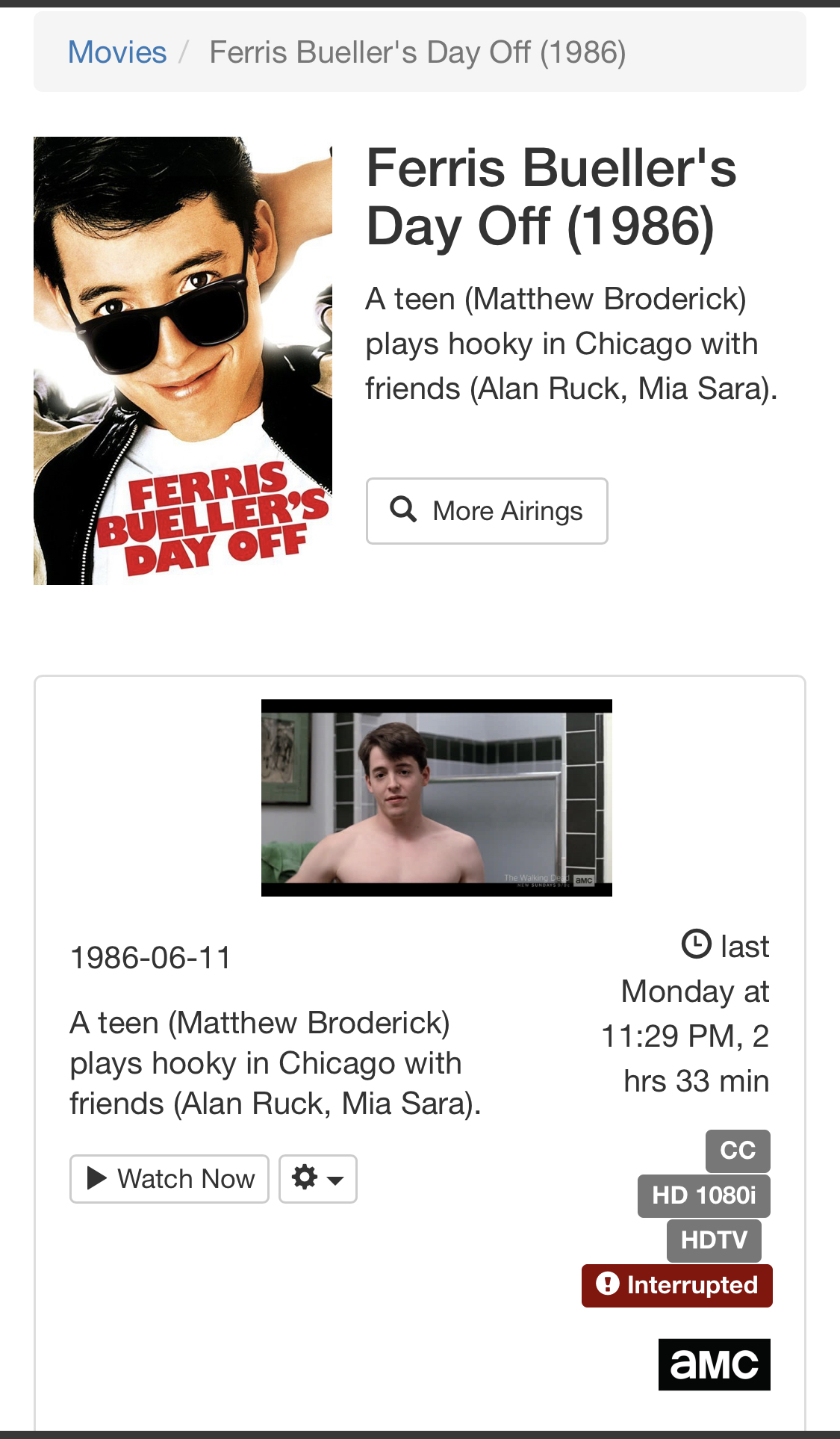

I’ve recently had a large amount of recordings being flagged as interrupted. It doesn’t seem to matter if it was recorded on a standard channel or TVE. I also have watched some of these recorded shows/movies and they were not interrupted, they played just fine with no interruptions.
I have my DVR settings set to 1 minute early and 1 minute late. I have a HDHR Prime with 3 tuners - cable card. The only thing I can think of is that if I am utilizing all tuners, it’s not honoring the 1 minute early and 1 minute late recording presets. I’ve not checked to confirm this is indeed the issue but wandered if anyone else is experiencing this issue.

2019/11/07 04:02:18 [DVR] Recording for job 1573117140-22 from 13177781 ch871 into "TV\Doomsday Preppers\Doomsday Preppers S02E12 2013-02-05 Hit the Ground Running 2019-11-07-0359.mpg" for 58m42.4585586s
2019/11/07 04:02:27 [IDX] Pruned 8475 expired airings from USA-PA54007-X in 311.8194ms.
2019/11/07 04:02:27 [IDX] Pruned 2134 expired airings from X-TVE in 79.9542ms.
2019/11/07 04:04:28 [NAT] Failed to discover upnp: write udp4 0.0.0.0:57064->239.255.255.250:1900: i/o timeout
2019/11/07 04:04:28 [NAT] Failed to discover router using natpmp and upnp.
2019/11/07 04:18:44 [DVR] Commercial detection finished with 10 markers.
2019/11/07 04:18:44 [IDX] Generating video index for file-244: Doomsday Preppers S02E17 2013-03-19 Gonna Be a Big Bang 2019-11-07-0259.mpg
2019/11/07 04:18:49 [ERR] Generating video index for file-244 failed: Couldn't reindex file: D:\TV\TV\Doomsday Preppers\Doomsday Preppers S02E17 2013-03-19 Gonna Be a Big Bang 2019-11-07-0259.mpg: EOF
2019/11/07 04:18:49 [DVR] Processing file-242: Movies\Jumanji (1995) 2019-11-07-0139.mpg
2019/11/07 04:18:49 [DVR] Running commercial detection on file 242 (Movies\Jumanji (1995) 2019-11-07-0139.mpg)
2019/11/07 04:24:07 [DVR] Commercial detection finished with 22 markers.
2019/11/07 04:24:07 [IDX] Generating video index for file-242: Jumanji (1995) 2019-11-07-0139.mpg
2019/11/07 04:24:07 [ERR] Generating video index for file-242 failed: Couldn't reindex file: D:\TV\Movies\Jumanji (1995) 2019-11-07-0139.mpg: EOF
2019/11/07 04:24:08 [SYS] Created database snapshot: backup-20191107.042407
2019/11/07 04:24:08 [SYS] Removing old backup backup-20191013.124700
2019/11/07 04:58:59 [DVR] Waiting 963µs until next job 1573120740-22 Doomsday Preppers
2019/11/07 04:59:00 [DVR] Starting job 1573120740-22 Doomsday Preppers on ch=[6070 1473 871 109]
2019/11/07 04:59:00 [DVR] Waiting 1h29m59.9969662s until next job 1573126140-ch6088 Revenge of the Nerds (1984)
2019/11/07 04:59:00 [TNR] Sharing existing connection to 13177781 for ch871 NGCHD (clients=2, len=0)
2019/11/07 04:59:00 [DVR] Recording for job 1573120740-22 from 13177781 ch871 into "TV\Doomsday Preppers\Doomsday Preppers S03E05 2013-10-29 Take Our Country Back 2019-11-07-0459.mpg" for 1h1m59.9969662s
2019/11/07 04:59:00 [IDX] Generating video index for job 1573120740-22
2019/11/07 05:01:00 [DVR] Finished job 1573117140-22 Doomsday Preppers
2019/11/07 05:01:00 [DVR] Waiting 1h27m59.4094249s until next job 1573126140-ch6088 Revenge of the Nerds (1984)
2019/11/07 05:01:00 [DVR] Processing file-245: TV\Doomsday Preppers\Doomsday Preppers S02E12 2013-02-05 Hit the Ground Running 2019-11-07-0359.mpg
2019/11/07 05:01:01 [DVR] Running commercial detection on file 245 (TV\Doomsday Preppers\Doomsday Preppers S02E12 2013-02-05 Hit the Ground Running 2019-11-07-0359.mpg)
2019/11/07 05:14:23 [TNR] Closed connection to 13177781 for ch871 NGCHD
2019/11/07 05:14:23 [DVR] Error running job 1573120740-22 Doomsday Preppers: write D:\TV\TV\Doomsday Preppers\Doomsday Preppers S03E05 2013-10-29 Take Our Country Back 2019-11-07-0459.mpg: The device is not ready.
2019/11/07 05:14:23 [DVR] Commercial detection failed with exit status 103
2019/11/07 05:14:23 [IDX] Generating video index for file-245: Doomsday Preppers S02E12 2013-02-05 Hit the Ground Running 2019-11-07-0359.mpg
2019/11/07 05:14:23 [ERR] Generating video index for file-245 failed: Couldn't open file: D:\TV\TV\Doomsday Preppers\Doomsday Preppers S02E12 2013-02-05 Hit the Ground Running 2019-11-07-0359.mpg: open D:\TV\TV\Doomsday Preppers\Doomsday Preppers S02E12 2013-02-05 Hit the Ground Running 2019-11-07-0359.mpg: The system cannot find the path specified.
2019/11/07 05:14:24 [DVR] Starting job 1573120740-22 Doomsday Preppers on ch=[6070 1473 871 109]
2019/11/07 05:14:24 [DVR] Waiting 1h14m35.9015795s until next job 1573126140-ch6088 Revenge of the Nerds (1984)
2019/11/07 05:14:24 [TNR] Opened connection to 13177781 for ch871 NGCHD
2019/11/07 05:14:24 [TNR] Closed connection to 13177781 for ch871 NGCHD
2019/11/07 05:14:24 [DVR] Error running job 1573120740-22 Doomsday Preppers: CreateFile D:\TV: The system cannot find the path specified.
2019/11/07 05:14:54 [DVR] Starting job 1573120740-22 Doomsday Preppers on ch=[6070 1473 871 109]
2019/11/07 05:14:54 [DVR] Waiting 1h14m5.3896188s until next job 1573126140-ch6088 Revenge of the Nerds (1984)
2019/11/07 05:14:55 [TNR] Opened connection to 13177781 for ch871 NGCHD
2019/11/07 05:14:55 [DVR] Recording for job 1573120740-22 from 13177781 ch871 into "TV\Doomsday Preppers\Doomsday Preppers S03E05 2013-10-29 Take Our Country Back 2019-11-07-0459.mpg" for 46m5.3896188s
2019/11/07 06:01:00 [TNR] Closed connection to 13177781 for ch871 NGCHD
2019/11/07 06:01:00 [DVR] Finished job 1573120740-22 Doomsday Preppers
2019/11/07 06:01:00 [DVR] Waiting 27m59.5052158s until next job 1573126140-ch6088 Revenge of the Nerds (1984)
2019/11/07 06:01:00 [DVR] Processing file-246: TV\Doomsday Preppers\Doomsday Preppers S03E05 2013-10-29 Take Our Country Back 2019-11-07-0459.mpg
2019/11/07 06:01:01 [DVR] Running commercial detection on file 246 (TV\Doomsday Preppers\Doomsday Preppers S03E05 2013-10-29 Take Our Country Back 2019-11-07-0459.mpg)
2019/11/07 06:09:49 [DVR] Commercial detection finished with 8 markers.
2019/11/07 06:09:49 [IDX] Generating video index for file-246: Doomsday Preppers S03E05 2013-10-29 Take Our Country Back 2019-11-07-0459.mpg
2019/11/07 06:10:00 [ERR] Generating video index for file-246 failed: Couldn't reindex file: D:\TV\TV\Doomsday Preppers\Doomsday Preppers S03E05 2013-10-29 Take Our Country Back 2019-11-07-0459.mpg: EOF
2019/11/07 06:29:00 [DVR] Starting job 1573126140-ch6088 Revenge of the Nerds (1984) on ch=[6088 1438 893 164]
2019/11/07 06:29:00 [DVR] Waiting 1h59m59.9901367s until next job 1573133340-ch6088 Revenge of the Nerds II: Nerds in Paradise (1987)
2019/11/07 06:29:00 [TNR] Opened connection to 13177781 for ch893 IFCHD
2019/11/07 06:29:01 [DVR] Recording for job 1573126140-ch6088 from 13177781 ch893 into "Movies\Revenge of the Nerds (1984) 2019-11-07-0629.mpg" for 2h1m59.9901367s
2019/11/07 06:29:01 [IDX] Generating video index for job 1573126140-ch6088
2019/11/07 07:00:00 [TNR] Closed connection to 13177781 for ch893 IFCHD
2019/11/07 07:00:00 [DVR] Error running job 1573126140-ch6088 Revenge of the Nerds (1984): write D:\TV\Movies\Revenge of the Nerds (1984) 2019-11-07-0629.mpg: The device is not ready.
2019/11/07 07:00:01 [DVR] Starting job 1573126140-ch6088 Revenge of the Nerds (1984) on ch=[6088 1438 893 164]
2019/11/07 07:00:01 [DVR] Waiting 1h28m58.3767833s until next job 1573133340-ch6088 Revenge of the Nerds II: Nerds in Paradise (1987)
2019/11/07 07:00:02 [TNR] Opened connection to 13177781 for ch893 IFCHD
2019/11/07 07:00:03 [DVR] Recording for job 1573126140-ch6088 from 13177781 ch893 into "Movies\Revenge of the Nerds (1984) 2019-11-07-0629.mpg" for 1h30m58.3767833s
2019/11/07 07:44:56 [TNR] Closed connection to 13177781 for ch893 IFCHD
2019/11/07 07:44:56 [DVR] Error running job 1573126140-ch6088 Revenge of the Nerds (1984): write D:\TV\Movies\Revenge of the Nerds (1984) 2019-11-07-0629.mpg: The device is not ready.
2019/11/07 07:44:57 [DVR] Starting job 1573126140-ch6088 Revenge of the Nerds (1984) on ch=[6088 1438 893 164]
2019/11/07 07:44:57 [DVR] Waiting 44m2.3710502s until next job 1573133340-ch6088 Revenge of the Nerds II: Nerds in Paradise (1987)
2019/11/07 07:44:58 [TNR] Opened connection to 13177781 for ch893 IFCHD
2019/11/07 07:44:59 [DVR] Recording for job 1573126140-ch6088 from 13177781 ch893 into "Movies\Revenge of the Nerds (1984) 2019-11-07-0629.mpg" for 46m2.3710502s
2019/11/07 08:09:27 [TNR] Closed connection to 13177781 for ch893 IFCHD
2019/11/07 08:09:27 [DVR] Error running job 1573126140-ch6088 Revenge of the Nerds (1984): write D:\TV\Movies\Revenge of the Nerds (1984) 2019-11-07-0629.mpg: The device is not ready.
2019/11/07 08:09:28 [DVR] Starting job 1573126140-ch6088 Revenge of the Nerds (1984) on ch=[6088 1438 893 164]
2019/11/07 08:09:28 [DVR] Waiting 19m31.3269512s until next job 1573133340-ch6088 Revenge of the Nerds II: Nerds in Paradise (1987)
2019/11/07 08:09:29 [TNR] Opened connection to 13177781 for ch893 IFCHD
2019/11/07 08:09:30 [DVR] Recording for job 1573126140-ch6088 from 13177781 ch893 into "Movies\Revenge of the Nerds (1984) 2019-11-07-0629.mpg" for 21m31.3269512s
2019/11/07 08:18:43 [TNR] Closed connection to 13177781 for ch893 IFCHD
2019/11/07 08:18:43 [DVR] Error running job 1573126140-ch6088 Revenge of the Nerds (1984): write D:\TV\Movies\Revenge of the Nerds (1984) 2019-11-07-0629.mpg: The device is not ready.
2019/11/07 08:18:45 [DVR] Starting job 1573126140-ch6088 Revenge of the Nerds (1984) on ch=[6088 1438 893 164]
2019/11/07 08:18:45 [DVR] Waiting 10m14.9977175s until next job 1573133340-ch6088 Revenge of the Nerds II: Nerds in Paradise (1987)
2019/11/07 08:18:45 [TNR] Opened connection to 13177781 for ch893 IFCHD
2019/11/07 08:18:46 [DVR] Recording for job 1573126140-ch6088 from 13177781 ch893 into "Movies\Revenge of the Nerds (1984) 2019-11-07-0629.mpg" for 12m14.9977175s
"ERROR_NOT_READY normally indicates a serious hardware failure."
Is this a mapped drive, or a physical USB drive?
Looks like its just intermittently throwing errors. Sometimes the first attempt fails, then the DVR tries to record again 30s later and it works.
In other cases, it keeps failing. Like for "Revenge of the Nerds (1984)" it doesn't look like it ever started recording cuz of the errors.
It’s an external drive connected with an esata to usb cable adapter to my pc.
I never have any issues accessing the drive and I ran a few programs to check it, no errors on any of them.
I’ll hook up another drive this weekend and try recording to it, see if I get the same errors.
Here is one that just happened... it’s also interrupted by 8 sec. obviously on this one I only have a 1 minute buffer added onto the end of the show.
