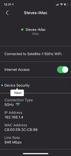

What does network settings on the iMac show? Can you load the dvr web UI there?
yes, no problem

The Apple TV is reporting no network connection to your iMac. Maybe it's on guest Wi-Fi?
Maybe you need to click that "device security NEW" thing in your screenshot and turn off any security blocking happening.

I dont use the security in the nether app... but the ATV appears to be on same network... I guess I'll try rebooting the router again, then the ATV, then theiMac and try to log back on...
