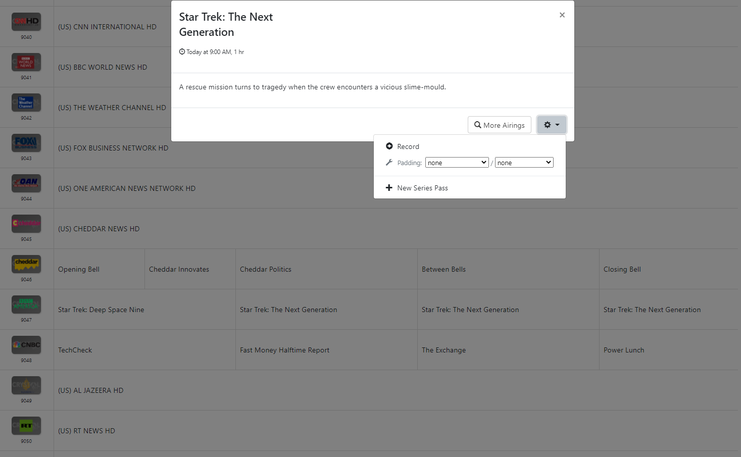

I can see channels showing up but nothing else nor do I know what to do.
It looks like your guide data is not working properly, as there are channels but no programs within them. If you get that corrected you’ll see the option to record.

Thank you. Can you tell me why some are showing up with the logos and others are not? Everything showing up are things I am not interested in. I see that it is also limited to 500 channels. Is there a way to select others not listed to make up the 500? Ideally I'd like to choose what makes up that list being populated.
Logos for channels for playlists are specified one of two ways:
  • via the tvg-logo tag in the playlist, or
  • via the associated guide data set in the DVR's web UI.
Correct. Only the first 500 entries from a playlist are imported; additional entries are ignored. If you wish to change this, you need to manually modify your playlist before directing Channels to scan it.

ii feel like i am starting to get somewhere here, but why are some showing as available and most are not? I really want to be able to choose from my full list of channels what the Channels app displays as available. How is it choosing some of these over others?
Sorry, total newbie here and I am a bit clueless.
As mentioned above, Channels pulls in the first 500 Channels and then stops. This was done for performance reasons. There is no way to pick and choose, your only option would be to modify the m3u so that the channels you want are one of the first 500.
