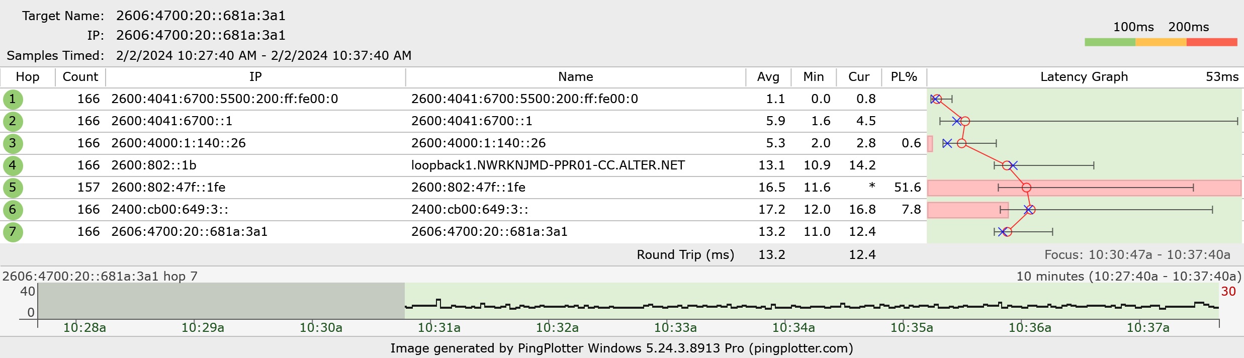

Looking back, the guide loading problems I've seen lately may have started when I enabled IPv6 on my router. FiOS recently started supporting v6 here so I thought I'd try it out.
Everything seems to be working well if not very well EXCEPT high packet loss on the link to the guide supplier. I use PingPlotter Pro to monitor the IP the guide is being loaded from per the Log. One hop is getting around 50% packet loss. I'll try to put the image of the results here.
So I'll shut down v6 to see if the problem goes away. But that's sort of short-term, is there a way to force just the guide update, or maybe Channels DVR in general, just use IPv4?
Edit: shut off v6, did full guide download, worked flawlessly. Looking into firewall or host config to limit to v4.
