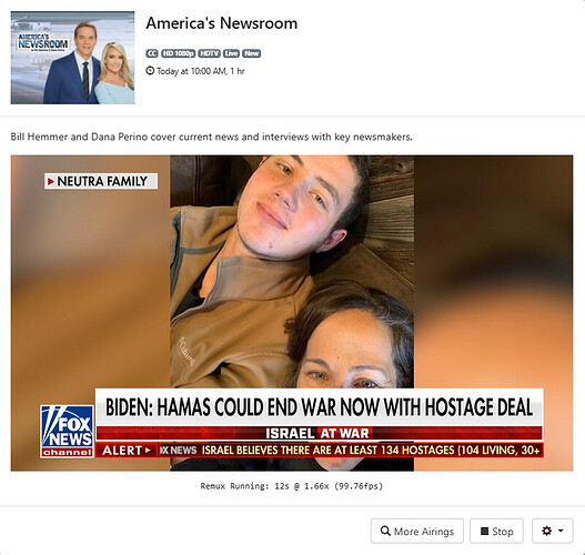

Is anyone else having a problem with the Fox News channel? I keep getting a 'Connection Lost Streaming to the tuner failed. Press play to try again. Timeout after 2s". If I hit play, it sometimes it comes back for a few seconds than, stops with the spinning arrow, then shows error message again, but most of the time it spins and goes to to the error.

I've already tried removing the source, and adding it back in in Channels setup, and stopping the Channels app in my Fire TV app, cleared data & cache, and restarting the app, and after doing all of that, it would work for a few seconds, than get the error. Going to stop/restart the Channels app on my server next.
