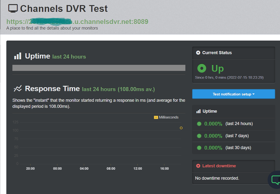

You can actually use the channels url that you connect remotely with. Example
URL https://12345678fdce.u.channelsdvr.net
Custom Port 8089

Nevermind. I was able to get Kusma running by first creating the volume then starting the container using the steps in the advanced configuration section of the Github 🔧 How to Install · louislam/uptime-kuma Wiki · GitHub
