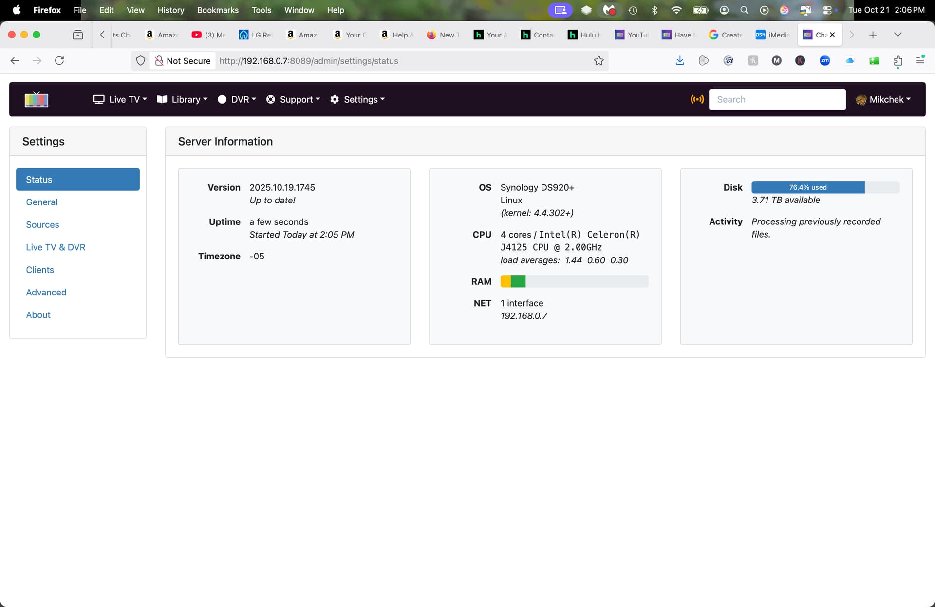

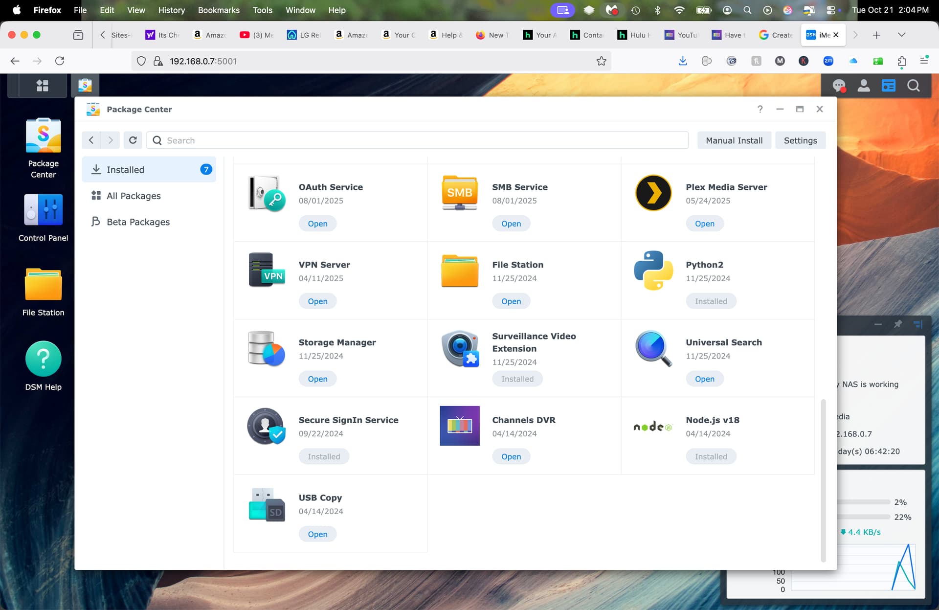

Is my install on Synology or Docker? please help!
I really wanna jump to Youtube TV...the last time I tried I kept getting the authentication error and I wasn't able to authenticate. I have been reading threads that its working now but I want to be able to use it also.
Synology
Agree Synology. If it was docker it wouldn't show in the package center.
ok thank you...so I should be able to get youtube tv working then right?
thank you

Based on what you're posting, you have the Channels DVR Synology Package installed and running.
By default (unless you changed it) it runs on port 8089, although it can be changed.
I have the Synology Package plus 7 docker containers running Channels DVR using different port numbers. Total of eight Channels DVR Servers.
I have some disabled, but it's possible to run multiples of each.
