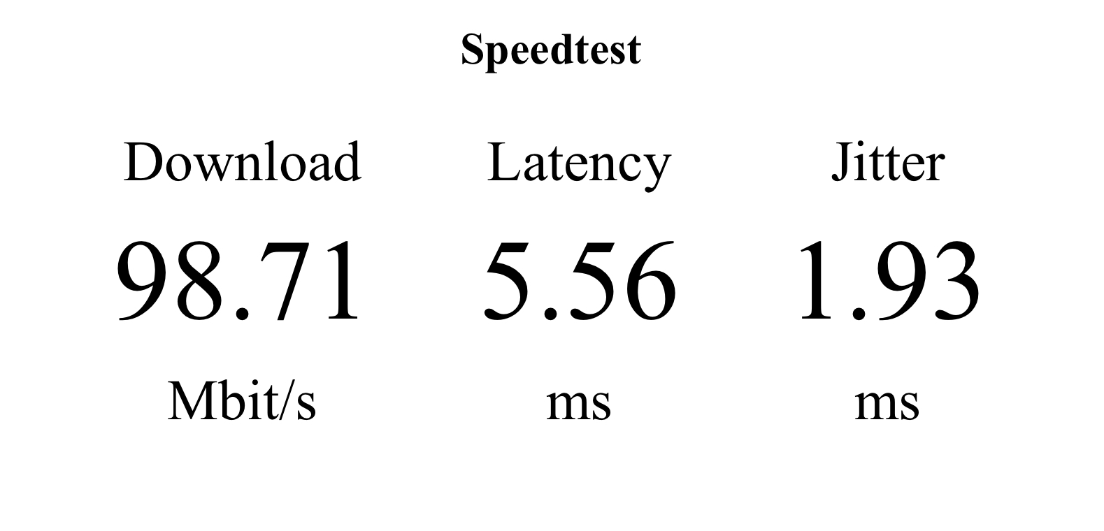

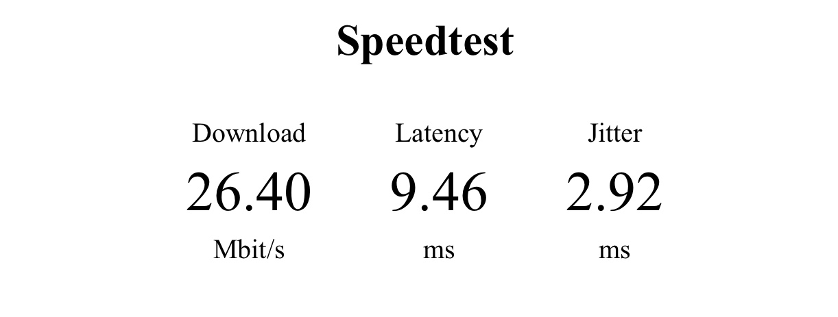

Of course! I have 4th Gen Apple TV, but no 4K, so only 100Mbps port. I disconnected Ethernet, I believe, after reading another thread on here that performance may improve over 5Ghz Wi-Fi. I just plugged back in and am getting the following. Performance is noticeably improved. Thanks!
