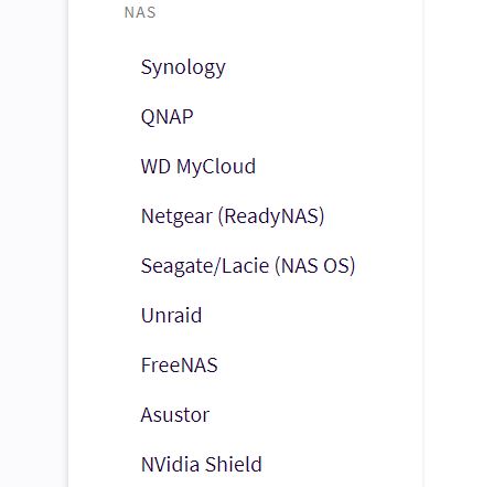

The only NAS options I see are:
NAS

So I used my router to turn my WD MyCloud external drive into a NAS but I can't figure out which software to use. There are a lot of options for WD MyCloud...

Only you can know which version MyCloud you have. Then pick from the list. You've probably already gotten to this page: https://getchannels.com/dvr-server/#wdmycloud From there you need to know which model and OS version you have, and how to get to the MyCloud Apps tab over your LAN.

That link you sent is where I'm stuck. I can't seem to figure out which version I have or how to access the my cloud interface.
Only MyCloud devices with a network port are supported. A USB drive is not going to work.
Ah that's my issue then. This is just a regular old external hard drive.
