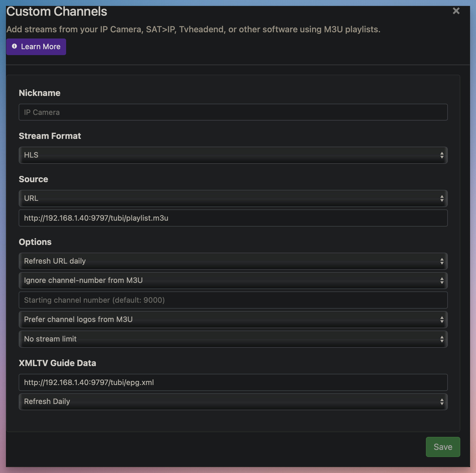

Thank you for the work in creating this docker. I am having issues with installing and was hoping you can help. I have installed the container on my Synology NAS and it appears to be up and running (see images). But when I install the source into channels, I get an error and am unable to add (again refer to image). Please help!

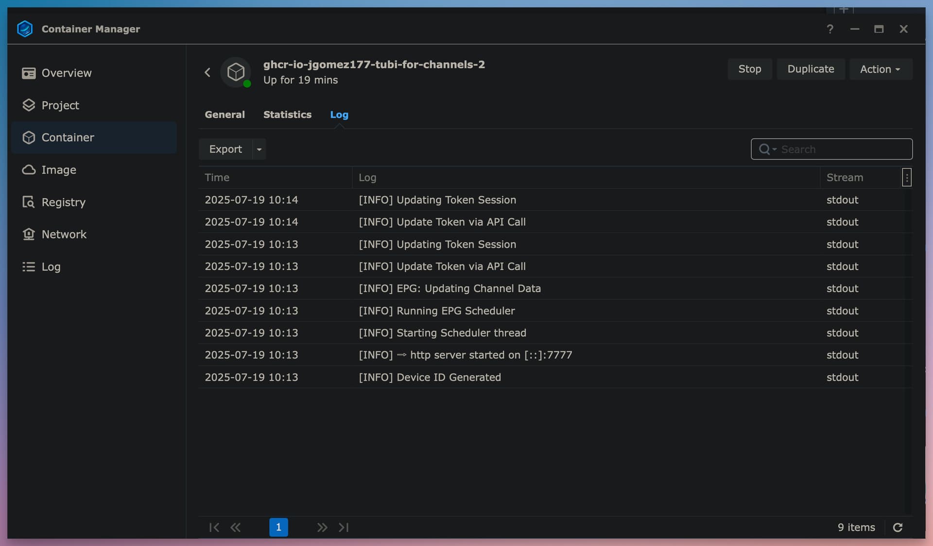

Here is the container log...

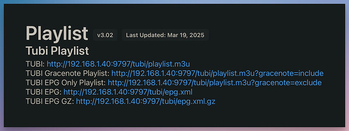

The container is serving this...

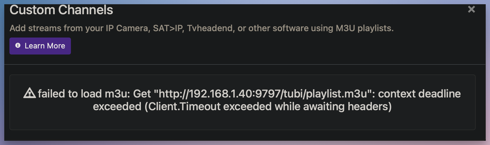

I get this error...
Is Channels also installed on your Synology NAS? If not, has the port been opened so Channels can see it? Is there anything else on network or server that is protecting Channels from being able to access this address/port?
Put that URL http://192.168.1.40:9797/tubi/playlist.m3u in a browser and see if it downloads the playlist.m3u file or times out.
Check the tubi container log.
Until the container generates a channel list, you'll see that error.
Also, sometimes when the container is busy it will timeout on requests.
