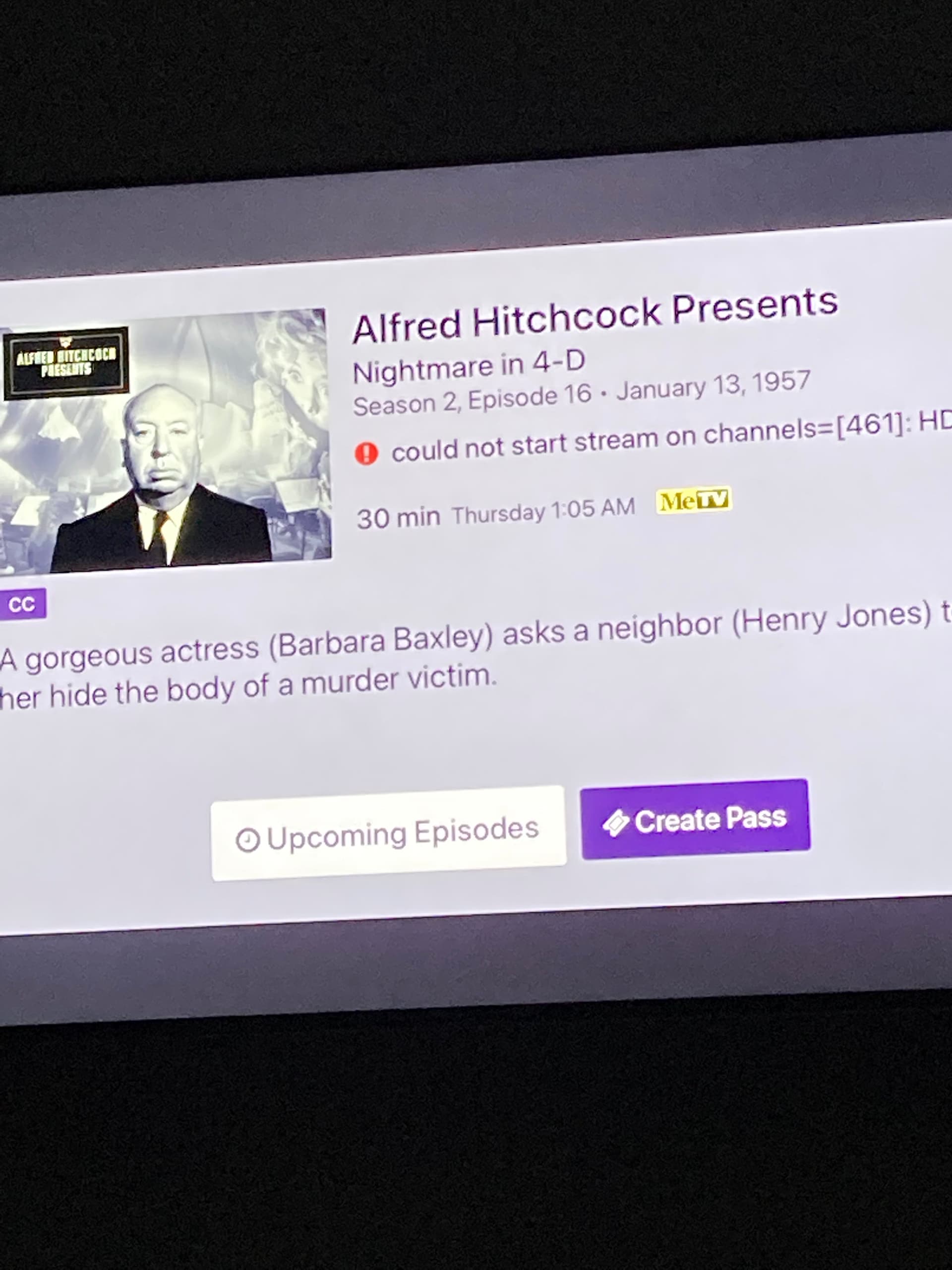

The attached picture is the error I get when trying to record Hitchcock or perry mason
“Could not start stream on channels 461 hdhoy”
Please provide details and logs. Until you do, no one hears anything except what Charlie Brown hears from his French teacher ...
