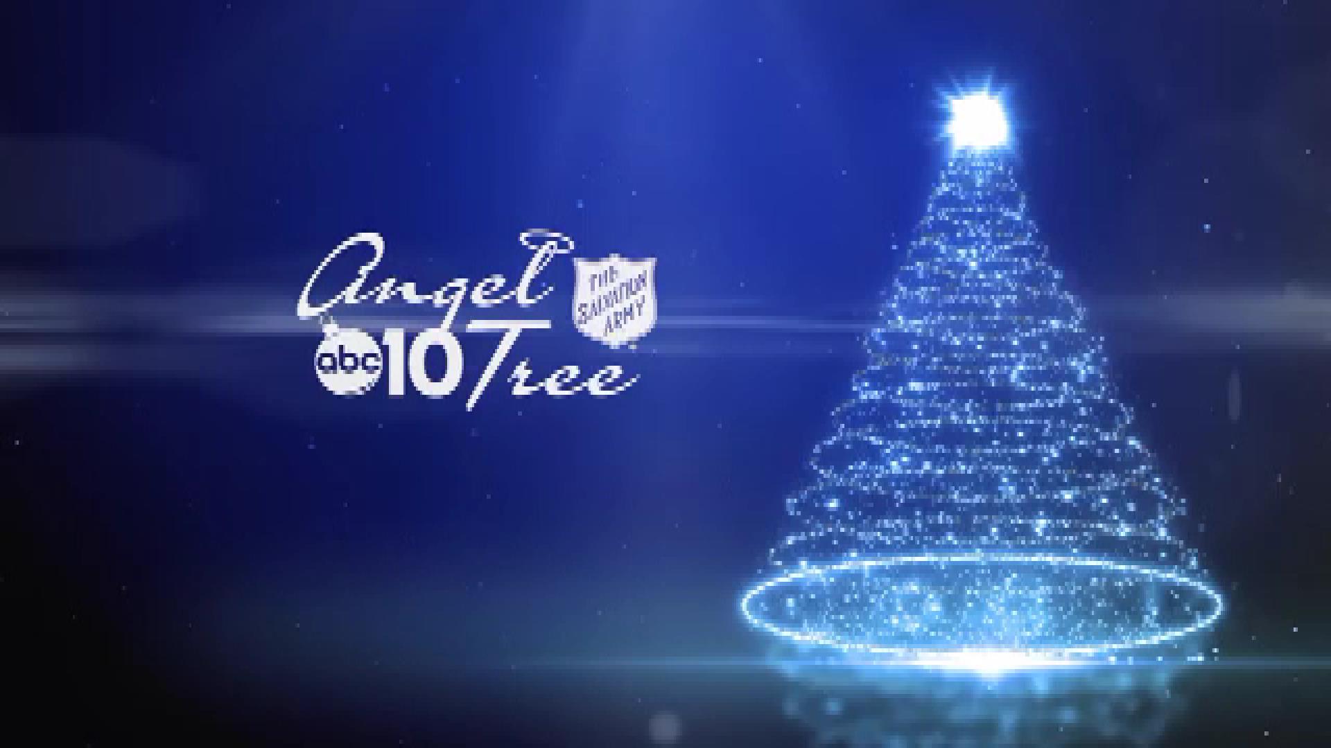

Issues with commercials on TVE
When watching DIY and a couple other channels, I'm getting a particular commercial from out local Channel 10 for their late night news. Every time the commercial airs, my TVE feed for DIY drops and I get a channel not found error. After a few minutes, I can tune it in, but it's an annoying issue because the commercial airs every commercial break.
This is in the Sacramento area on KXTV channel 10. I'm running the latest Beta on my Windows 10 DVR. Happens using both a FireTV4k and Shield TV.
Anyone else seeing this issue or have any suggestions for fixing it?
I will submit diagnostics.

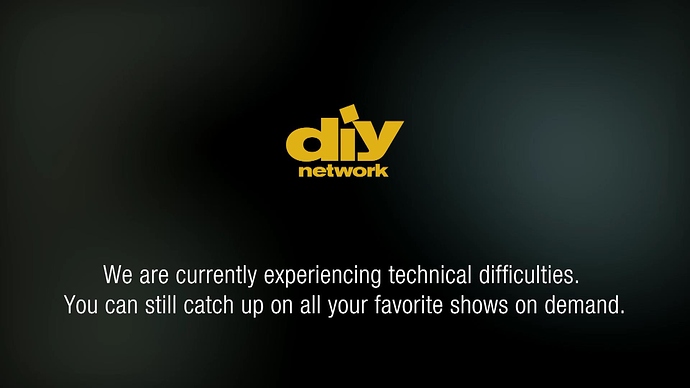

Recorded Building Off the Grid - Mud Men this afternoon from 3-4pm on 6108-DIY and although there were no disconnections or errors in the log, there were a lot of these in the recording.
Just wanted to say I did get some local commercials
and also some of these

I have been trying to watch DIY chann today, the sever updated to 11.19.2312 yesterday.
DIY via TVE is freezing up alot.
Pausing it for a few min to get it to buffer the channel seems to help.
