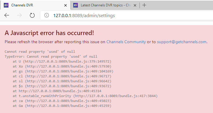

I only see this on the settings page and happens on two different PCs.
This happened immediately after holding down the update button and it installed the 9-22-2020 build.
Logs have been submitted as e3e1cefe-100a-4f1e-9e45-f9d30f178c5f
Please try updating to the latest build. Open powershell and paste:
curl.exe -XPUT http://127.0.0.1:8089/updater/check/prerelease
I think we're good now. Thanks.
