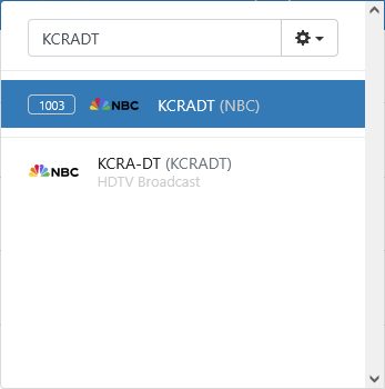

You can fix it on your dvr
CDVR is only using the data it is getting from the service providers...
You could go in and manually set a guide mapping
Click on the hdhomerun source then KCRA channel link in it.
Select edit on right side and select all sources
Type KCRA in search field
Select a different feed...mine showed 7...
Some are sub channels and some on sdtv versions of hd channel that might have correct data.
After fixing tell channels to redownload guide data for that sorce if needed and wait a few to check :slightly_smiling_face:
Thank you for your response. It's fixed now.
Yep, KCRADT is the correct one
