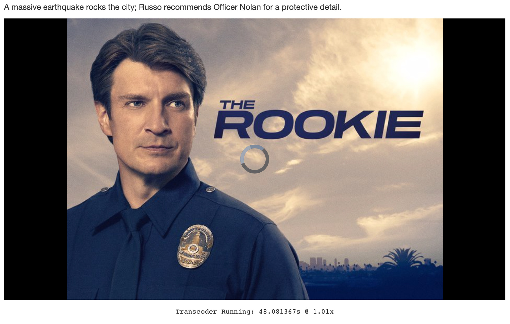

Just did some more testing, streaming live via web browser (Safari). Selected an OTA channel, and after ~5-6 seconds it started playing (this is at home on same network). I stopped that playback and tried another OTA channel, waited around 45 seconds and it never started playing, although it said Transcoder running (image attached). I went back to the first channel and it did the same thing, hung at transcoder running. I next tried a cable channel (AVC / MP4) and it played right way (I think this just remuxed, not transcoded).

I sometimes see this. When you get this, try clicking a few seconds in on the progress bar and see if it starts playing. Or if you wait until over thirty seconds have transcoded you can also skip ahead and it should start playing.
Looks like this, notice pause bars makes it look like it is already playing, but current playback position is still at 0:00 and transcoder output is at 3:47
