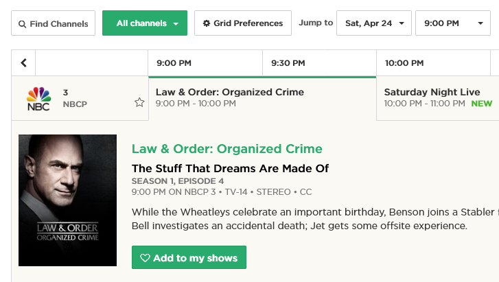

Here's your scheduled job that was deleted.
It probably didn't have the Season and Episode listed in the guide data for this rerun of Episode 4 on Saturday night, 4/24. Once it picked up the Season and Episode in the guide data it would schedule it for you if you're not recording NEW only.

That scheduled airing that was deleted is future.
Next Saturday's rerun of this coming Thursday's Episode 4.
Usually happens when it first appears in the guide with no Season or Episode and then a new guide update has a Season and Episode. It deletes the old listing having no Season or Episode and reschedules the new listing showing the Season and Episode. I can tell this was the case with yours, since the job it deleted was tms Show ID (SH035420690000) - Epoch Time (1619323200). If it knew the Season and Episode it would have been tms Program ID (EP035420690004) - Epoch Time (1619323200).
