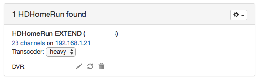

So just have this setting:
Where it says Transcoder: heavy is all I need to do?
Also, does ComSkip still work if Extend is transcoding before placing in DVR folder?
Yes that’s all you need. Everything will work the same, though comskip may be a bit slower on h264 compared to mpeg2.
