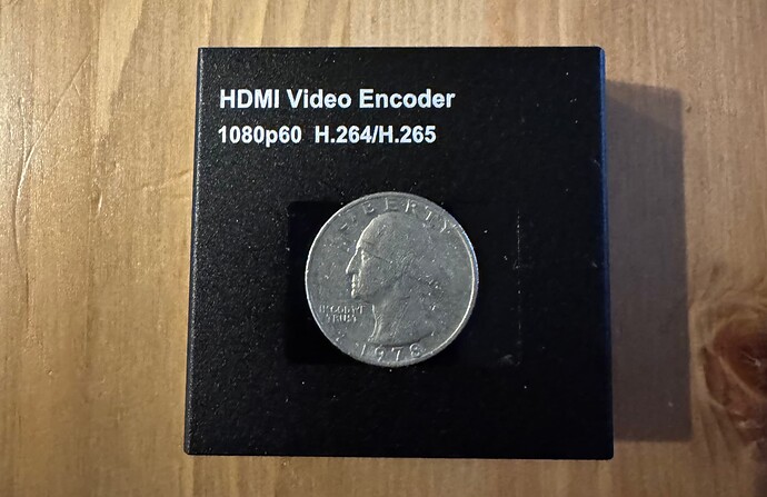

I picked up a MINIENC1 a month ago to try it out. It works just as well as the ENC1V2 for what Channels users would be using it for.
Just make sure you upgrade the firmware as the shipping firmware has a bug that locks it to 30fps.
It’s a tiny thing:
